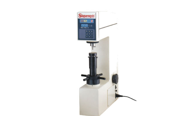

We are using this one in the Lab. For field measurements EQUOTIP
Automatic Rockwell Hardness Starrett 3816
