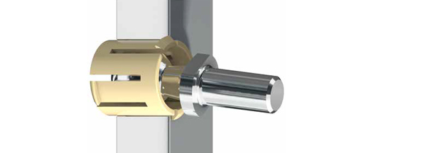

I've been looking for a spring clip, like a terry clip but with 3 legs instead of 2 so that you can push a circular rod into it end on. I know I've seen these & I've been googling like mad but can't find them, any suggestions?
Something like this quick sketch.

Push Nut Cap

Not grippy like that. I should have mentioned that I need to be able to remove the rod from the clip & replace it.

Unfortunately not. I need to be able to support an array of small, rigid cardboard tubes, roughly index finger sized. They need to be held firmly but easily removed later. I know that I've seen the exact clip that I want but can't remember where or the correct name.

Try "tube closures"
http://www.crh.com.au/products/equipment-legs-feets-tube-closures?gclid=CKGPpcjC88oCFZVahgodjY4H6A
http://www.carpin.com/metal-closures.htm
