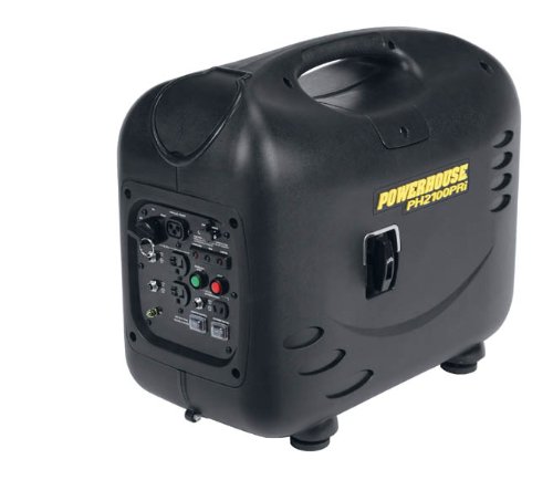

Re: Power Outage & Use of Inverter with Batteries for AC Power
09/04/2016 1:27 PM
He could just go with a inverter generator....2000kw remote start $620
https://www.amazon.com/gp/product/B004RCQ05Q/?tag=trgen54355-20
