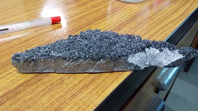

Previous in Forum: What Is It?   Next in Forum: Recover Copper from Nitric Acid Mixed with Copper
3 comments
Engineering Fields - Mechanical Engineering - I am here to help!!
Posts: 192
High Chromium Casting Defect
12/22/2016 4:04 AM
We were doing some research on High chromium casting and following defect observed in it.
The picture shows the section of the casting and it is actually the half section, the other half is exactly the mirror of the section. In other words the black acicular structure is formed only in the middle of the casting thickness. I don't what is this and why it happened?
The pouring material was High chromium white cast iron with Cr around 26%
Can anybody throw some light on it?
Re: High Chromium Casting Defect
12/22/2016 9:06 AM
Could be a Kirkendall effect. I'd try to rule that out first.
Re: High Chromium Casting Defect
12/22/2016 9:19 AM
Can we get some close up photos of the structure?
Posts: 1394
Re: High Chromium Casting Defect
12/23/2016 6:27 PM
Not that I can offer any help on this, but some information on the casting equipment and how you used it might be helpful (to other viewers). It looks like the center of the metal cooled off at a very slow rate to allow crystals to grow.... perhaps in a gas bubble
Register to Reply 3 comments
Previous in Forum: What Is It?   Next in Forum: Recover Copper from Nitric Acid Mixed with Copper
