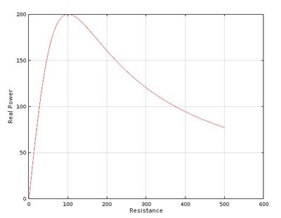

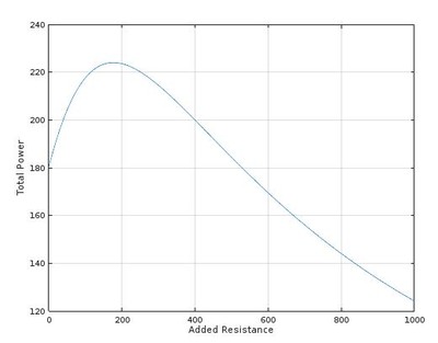

OK, thought about it some more and ran some numbers. Here is a simpler explanation. The same current goes through the heater and added resistance. So the power (current x voltage) is proportional to the impedance V = I (R + jX).
Total power = 400 VA and real power = 180 W for heater alone.
Power = 180*R + 357j *X [ sqrt(1802+3572)=400.]
The total power and real power will be proportional to the resistance R and inductive reactance X.
It turns out that as you add series resistance, the total power increases to a point and then decreases. Using the formula for power:
P = (R-jX)/(R2+X2) and plotting the real power

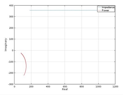

Re: Series Heating Effect vs. PF . . .
12/23/2016 12:04 AM
I've been trying to find a simple answer.
If voltage is constant, power is inversely proportional to Impedance: P = V2/Z
If impedance is real (resistance only), if resistance increases, power decreases.
If impedance is complex (resistance + reactance), then if resistance increases (real part of impedance) then it does not mean that real power increases. Here's an example (Complex plot of Z in blue and Power in Red)

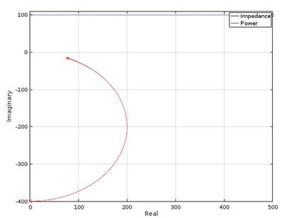

12/23/2016 10:41 PM
If you start with a pure inductor and add resistance, the total power dissipation (real power) will rise to a maximum when the resistance equals the inductive reactance. After that point, it will decline.
The OP had a heater which had resistance and inductive reactance, and in his case, the inductive reactance was greater than the resistance. (400 VA and 180W equates to 180 real power and 353 reactive power.) So adding more resistance caused the total (real) power to increase.
If there had been more resistance than inductive reactance in the heater, adding external series resistance would have resulted in a decrease in real power as it would have been on the downward slope of the power curve.
Impedance and Power on the complex plane:
Impedance = 100j + Resistance
Resistance = 0 - 500
Real Power as a function of Resistance:
12/23/2016 11:07 PM
Wait, if the load is purely inductive (or purely capacitive), so no resistance, what mechanism is responsible for the heating?
12/24/2016 11:21 AM
Power is a complex quantity if inductance or capacitance are present in the circuit. You are correct. If the load is pure inductance, power is purely imaginary and there is no heat. (See first plot in #12, at zero resistance power is 0 - 400j)
