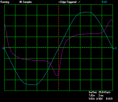

The current at rated primary voltage, no load, is both the things you state, but the second is less accurate...
The magnetising force is the primary current x primary turns - this is not affected by consideration of losses in primary winding resistance or magnetising losses which change the "back-e.m.f." opposed to the applied supply voltage. The primary current is the magnetising current. It may be convenient for analysis to represent losses as a parallel resistance, but this is accurate for engineering purposes only because losses are small and can be considered almost constant over normal supply voltage range.
Actual magnetising current is not sinusoidal and drawing an equivalent transformer circuit, which is assumed to be linear and work at just fundamental supply frequency, is a convenient simplification which is accurate enough to understand what is happening.
The following image is oscilloscope voltage and current into primary of a toroidal transformer. These, as you may know, usually give more extreme saturation behaviour than the typical E-I lamination construction.
Note that the current wave is far from sinusoid - the distortion of voltage, flattening at the peaks, is in the house mains supply.
