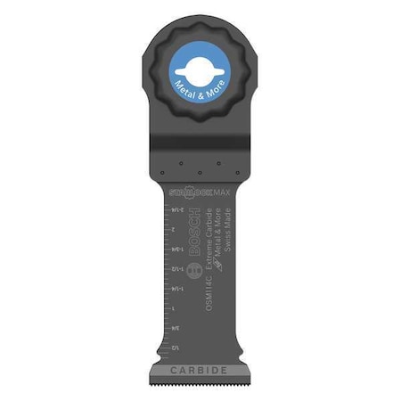

Good advice. I've used my Bosch osc tool blade to cut through nails and staples, though not on purpose. I was cutting through wood and the nail/staples were there in the way. The Bosch blade cut through it, but it does slow down the process.
I've heard that the Diablo Carbide tipped Demon blades are suppose to be the bomb! A bit pricey, but I heard they cut tool steel.

Not looking to actually cut nails.. a couple of staples in a tight spot. I just don't trust the bi metal blade for anything beyond tinfoil.
I was leaning towards carbide too. The diamond blade from "Fein" has few reviews but big claims. I agree that it's best for stone etc.
I use Torch sawzawl blades as well as Diablo carbide (GREAT) and one of my faves the UGLY blades.
the blades are so pricey I wanted your thoughts.. thanks!

Re: Oscillating Tool Diamond Blade
03/07/2017 11:32 AM
OK yes, the Bosch Carbide blade kicks all forms of a**. Now I want to know if a 3" plunge depth carbide blade exists? A little longer is welcome, too!
I saw a blade advertised as an extra long 4.25" (actual cutting depth 2.48"). Booo.
I'll take an unlimited number of such blades (3" - 4" carbide tipped).
