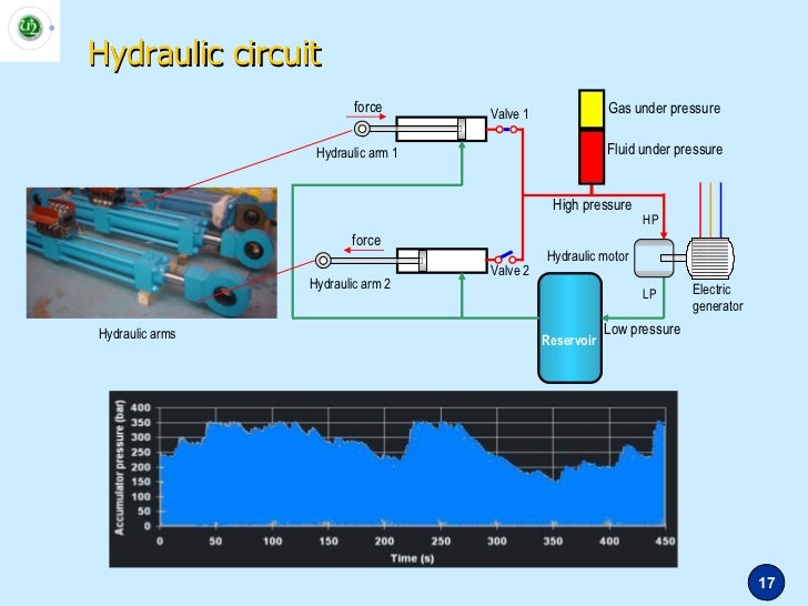

Let say I have a large and available force that I want to convert to electrical power.
Let's say I can couple two rotary actuators and that most of the time both actuators will be driven slowly back and fourth anywhere from a few degrees to as much as 90.
My experience with hydraulics is limited to gate operators that I have completely completely disassembled and reassembled for service/repair. Most were linear, but a few were in ground rotary units.
I could use linear hydraulics, but rotary seems like a better fit for this application.
In the end, I'm not quite sure what I'd need in terms of accumulator, motor, generator, and bypass valves, etc.. but I'm gathering information.
I'll be heading away from the grid for a few so I'm just putting this out there to simmer.
I've been around the google-sphere a bit on this topic, but I'm looking for some sources of knowledge. If you know any that would help? please provide a source.
In terms of the amount of force available in the rotary action?
anything from 100 to 100K lbs of force should be achievable.

I suspect something similar has been done before a long time ago. Driving your two pistons in apposition was one of the basic mechanisms known as a balanced beam engine. One of its features is that it can convert rotary motion to reciprocating motion, or reciprocating motion to rotary motion, depending upon the timing of the valving.
Your high pressure accumulator/low pressure reservoir are similar to the basic functionality of James Watt's original steam engine. Your system uses compact hydraulics instead of the reciprocating balanced beam, with the check valves essentially ensuring that the fluid flow is unidirectional as it enters the hydraulic motor.

The hydraulic circuit shown in your post does not work!!! Without non return valves the oil will just flow in and out of the reservoir as that is the easiest path. Add non return valves that allows oil to flow into the cylinders from the reservoir as they extend and non return valves to allow oil to flow out of the cylinders to to the accumulator replacing valves 1 & 2 as they retract. If you are reusing rotary actuators, these are normally double acting cylinders so the same arrangement of non return valves on the annular end of the cylinders allows you to extract power from the return stroke. So for every cycle you get the area of the full bore end times the stroke plus the area of the annular end times the stroke. For rack and pinion type actuators this doubles you flow rate.
If the total power output is going to be above a few kilowatts you will need a cooling circuit in the oil reservoir. Assuming that your efficiency is 50% (you should be so lucky) then the other 50% ends up as heat in your oil unless you build in a way of dissipating it.
