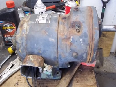

The other week I did a road trip to work on stuff for a buddy of mine and came home with a bunch of goodies as payment one was a Burke Machining Co horizontal mill from the late 30's to mid 40's I pulled out of load of scrap iron that came from some farm clean up job they had!
It was a but dirty and rather rusted up but for the most part complete!
I built a stand for it out of a well weathered piece of 3/4" plywood and misc other weathered pieces of lumber I had laying around to try and make for a fitting and properly aged match to the old mill. It actually turned out to be a perfect match!
Amazingly despite it ride to the scrap yard in a truckload of old iron it was in all around very good shape other than being rusty form apparently having spent some time outside.
Even the original gearmotor still worked. It needed to be taken apart and cleaned plus get new shaft seals which turned into a good long day project being the original seals were impossible to source so modern ones (~$10 for the pair) had to be substituted with a bit of remachining work.
It's a repulsion type induction motor and despite being only 1/2 HP it's wound and built heavier than any modern 1 HP unit plus with the gear drive it weighs around 70 pounds!
Every major component got cleaned up and adjusted back into spec including the original table automatic power feed system.
I even rebuilt the original lamp with updated parts too!
This is what it looks like after a week's worth of spare morning and evening tinkering work.
Not bad for a scrapyard rescue that was minutes from going into a rail car destined for the Canadian steel smelter.
My main plan is to set it up just for cutting slots and keyways in shafts and whatnot.

Everything cleaned up and moves free from one limit to the other with very little noticeable wear or looseness through the midpoints of travel.
More than accurate enough for the types of work I will ever do with it.
The biggest issue with it was getting everything apart and going after it with a wire brush and wheel to get the surface rust off which with this old cast iron they used back then unless it buried in the dirt for a long time it doesn't develop the deep pitting or heavy scale that so much of today's metals do.
Also, despite having taken a ride from where ever it came from to the scrap yard in the back of a scrap iron truck nothing is banged up or bent out of shape.

TCMTECH: So what is the spindle taper that you now need to procure tooling for? I believe these use a Brown and Sharp taper. But there are various, depending on the size of your mill. They made mill sizes from 0 to 4. I can't tell from the photos if the outboard overarm support for holding the end of a mill cutter arbor is still with the machine. But you'll need to fabricate one if you get a milling arbor. You can do much work with out this using end mill holders and such. If you have a real good lathe you can fabricate your own tooling. For reference, my first milling machine, a No2 Rockford Miller. Uses B&S#9 tooling. It was overhead line belt powered originally, and previous owner put a LIMA conversion kit (3phase 3HP motor with 4 speed transmission). Pre WWII conversion. If your use is keyway cutting, then you can procure a minimal amount of endmill holders for the various key sizes. So now you have a new job of tooling up. Do you have T-nuts and clamps, machine vise, as minimal set up tooling? I'm assuming this is your first mill outside of the all in one I think I recall you having at your brothers. I think you were needing a tie bar for some heavy equipment. Did you ever make a replacement?

It has the support arm.
I have not gotten to making the necessary tooling adapters yet but I did get a part of a driveshaft that was attached to the spindle that has the correct taper on the end so I will use that for a reference when making whatever tooling adapter parts I need.
I plan to use the machinists vice from my Smithy for now on this being it doesn't get used much otherwise.
