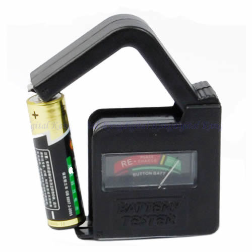

I have one of the above tester, useful for testing continuity in domestic appliances etc. i thought of using for testing of dry cell batteries. It consists of two pins connected with small cables. One of the pin holder has small button type battery in series with LED lamp.If there is continuity the circuit is closed and lamp lights up. I wish to provide small switch to disconnect the cell batteries for testing the life of the other batteries.I hope the system will work.
Posts: 2217
Good Answers: 70
Re: continuity Tester
08/17/2017 4:29 AM
An LED light will not show battery voltage nor the charged state of the battery. You'd be better off using a meter designed for that purpose. Even Harbor Freight cheap freebie multi-meters have that function

It probably wont work. If you have a single cell, the voltage drop you can afford from charging batteries is about 0.2V. A LED definitely has a higher forward voltage drop that that.
Moreover, if it somehow gets to work, connecting batteries in series with different charge levels are likely to burn not only the diode, but also the cables. Listen to the wise and do not make experiments with batteries if you do not know what you are doing for your own safety.

To simply convert a continuity tester to a "cell" tester is not a simple task. There are two major problems:-
1.) Continuity is an easy thing to measure, and, essentially is a YES/NO decision. I realise that a very low resistance might give a YES decision, but, when you're just trying to see where wires are connected that's not normally a problem.
Testing a battery by comparison is more of a continuous (unfortunate choice of word considering the context) measurement: look at the pictures of the testers others have posted links to. Some show a direct readout of battery voltage e.g. 1.32V; others show a needle which moves from a red area through an amber area into an increasingly green area.
2.) Look at the button cell in your existing continuity tester. I bet it's a special 3V cell (battery?) not a standard 1.5 volt cell. This is because nearly all LEDs have a forward voltage drop of greater than 1.5 Volts. Do a search of say Digikey for LED; out of ~22,000 results this is the choices you get if you want to narrow the search by forward voltage:-
there are lots of pages to scroll through.
So a single "test" cell will not provide enough voltage to forward bias an LED.
If you want to design a cheap battery tester for your friend I'd buy one of the existing ones and reverse engineer it. His skill is clearly in cost reduction of both material and production.

2.My friend is having cottage industry where his objective is to make something damn cheap but still serving purpose. His present product is well received in the market comparing the cost. It is bought by small shops or electricians who do small house appliance repairs. Product shown by others are good and long lasting,
3.Present product has 2 Nos. button cells voltage is not mentioned.
I will try to element these dry cells by shortening the wire connections and see what is the result.I will inform you regarding the same.
Just compare the cost, he is providing 2nos cells, 2nos plastic holders, cable, LED bulb for just $ 0.50.Still he has some profit.

I have tested this unit without cells, I found it working good as battery tester. However i could test 2nos cells in series as it needed 3 v for lighting LED bulb.
