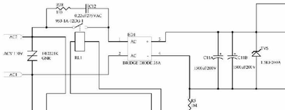

I've been trying to design by myself a PMDC Brushed Motor controller for treadmill purposes. Attached you can find the nameplate of my motor, and the schematics I made about the power stage. In the schematics you can see the components that I have selected for the PCB (the ones that will be used in real life). I don't attach the microprocessor stage, it will just simply output the PWM signal, process speed signal, current measurements, (adjustment of duty cycle according to load) and other minor functions.
PWM frequency: 10 kHz. but it may vary depending on the performance in empirical tests. The microprocessor will be a STM32 nucleo, so 3.3V port voltage.
I haven't simulated this circuit. I want to make a PCB to take some real measurements. This is a first prototype for a college project. It's hard to expect that everything will work at first attempt. So I expect to make further improvements.
The main reason of this post is for you to give suggestions about the design, and help me determine if I need a snubber across the MOSFET, and what kind if needed (RC, RCD, etc). I haven't found a solid guideline to design a proper one according to this application.
I attach the schematics via links since when I attach them directly in the forum, they lose the quality.
Schemactics:
1- AC Input 120VAC

I do not think you will need a snubber.
Circuit diagram 1 - AC input
120VAC power is usually earthed. So putting another earth ground on the outlet side can be real trouble. Your symbol for GRND1 is a real earth or at least power outlet earth, GRND2 symbol a common [COM] - appropriate labels/symbols needed. Even without, your circuit common is switching between line & neutral every half-cycle. You do not have any RF bypass capacitors or filters to stop noise going back into supply

Hi,
I might have used ground symbols wrongly. I just wanted to point out that I have two different grounds, the 5V ground and the "Vbus" ground, which are "DC grounds". Since I have optoisolation, I have different grounds. Could you explain to me again the problem with my 120VAC grounding scenario?
I plan to add an EMI filter to the 120VAC input. Is that okay?

120vac 1 phase input may not provide the expected output voltage.
To efficiently use your input circuit you need to draw current for more of the available conduction angle. As it stands I would anticipate closer to 100 volts average output. As the filter capacitor "grows" in size you conduct for a shorter and shorter period on the input diodes, and the current increases to keep the input power matching the output power. I can easily see exceeding 100A peek on the input while drawing 27 amps average on the output side.
With many motor controls there are 2 control loops - the inner loop being motor current, and the next outer being for speed or voltage. This allows controlling and limiting motor current / torque and then controlling the speed.
A full wave SCR controlled rectifier would be a much simpler circuit. For pennies more adding a "regen" SCR bridge would allow for four quadrant operation of the motor.
A more complex circuit could use 4 mos fets as the power conversion from Ac to DC. The topology would be similar to an "active front end" for a four quadrant low harmonic regen drive. Also reference matrix converter.

Many treadmills DC controllers use a relay to switch the 120VAC to the bridge rectifier input. I've replaced the relay system by a triac system with zero crossing. Do you mean this is no an efficient way to do what I intend? 100A peak would probably roast my circuit. My bridge rectifier is 35A, the triac as well.
A full wave SCR controlled rectifier would probably change the whole project idea, since I'm using PWM driven system. But as you say, it could be easier.

The delta voltage on 4400UF at 27 amps on a single phase rectifier is 50 volts for the discharge cycle. The charging period will be for about 45 deg out of 180 deg. I think your rms for the diode bridge will be about 55 amps.
You could consider eliminating the power supply caps altogether, and let the FET switch the rectified un-filtered AC line volts.
If you want to filter then you will need about 45,000 uF for a 5 volt ripple. - But the peek and RMS on the filter goes up. If you add inductance on the rectifier output output you can smooth the current ripple.
No matter, you will not achieve full motor voltage with single phase. Three phase you have a chance.

It is not as simple as just having a big reservoir cap on DC supply. The motor inductance/flywheel diode will keep the current rolling through dips in full wave rectified - very big reservoir just increases bridge peak current and mains supply distortion.
Diodes will take considerable overcurrent, they only drop 1 - 3 volts, but FETs can turn on to high current and voltage together and are limited by safe area /time chart and avalanche characteristics when switching off circuit inductance (the bits that are not cancelled by RURG flywheel diode).
Best way to get to grips with this is connect FET up with fast overcurrent hard-wired to FET driver to limit to 25A and measure some motor characteristics [inductive current rise] & diode/FET currents.

In North America - only use the "plug in" protective earth ground for grounding your chassis and metal parts - to minimize shock hazard.
Use the neutral line as your circuit common.
The usual "plug-in" supply you can only use about 12 amps - higher than that you start tripping breakers.
So your output power will be limited to about 1 k watt.
Treat the project as an experiment to see how the circuit behaves --- to put into production you need another layer of safety and reliability testing, so lets just focus on learning the basics.
lets start with a power limited output of 12 amps - with your input capacitor filter lets just make a few assumptions to get the order of magnitude of componentes. Start by considering the capacitor charged to the peak of the AC line rooot2 x 120vac. The motor inductance is going to draw constant current for a half cycle of 60 hz - The voltage ripple will be found from solving i=C dv/dt - use i = 12 amps, the chosen C, dt = 1/(60 x 2) ---solve for dv --- this is an approximation to ensure you are in the correct order of magnitude for your chosen components - a loose rule of thumb.- practical electronics.

The simple resistor & relay inrush surge limit is the way to go.
Supply resistance [16kA S/C @ 115v] = 7 milliohm But note that 10 kVA, 230V out Centre-tapped single phase supply transfo may be 100 mohm @ 115V - USA denizens please quantify.
2 metres 6sq.mm copper power cord = 12 mOhm
Ditto - in wall = 12 mohm
2 x 2200 μF 200V caps Effective series resistance @ 100 Hz (reactance 0.36Ω) = 35 mohm.
EMC filter Schaffner FN350 = 7 mohm
TOTAL 73 mohm [I left out diodes & Triac but may be 20 mohm more]: Surge Current 115/.073 = 1600 amp: RC = 0.32 millisecond.
Current will fall exponentially to 220A after 1 ms. Surge rating of bridge 400A/8.3 ms 1/2 sine@25 Celsius. I2t of 660 may hit minimum of 32A HBC fuse.
Triac must carry 30 amp with approx 1.5V drop - a significant heat-sink size/cost & power loss operating.
Supposing bridge diodes & Triac conduct for 30 degrees in 180, leaves 7 ms to supply from 4400 μF. Conducting 1/6 of time requires 30 amp x 6 = 180 amp during conduction. As pointed out by other post, volts drop on caps about 40V @ 30 amp while diodes not conducting. N.B. That 80mohm odd circuit resistance will drop some 14V @ 180 amp.
You can see why heavy current single-phase full-wave rectifiers traditionally used inductor input filters to cut surges and spread conduction angles.
Without capacitors to cause surges, a 3 phase, 6 diode bridge output will only dip about 15% from peak, while mean value is 95% of peak. Conduction angles are 60 degrees. You can see why heavy current equipment is usually 3 phase.

I did not examine your AC supply circuit diagram for your thread question is about the snubber circuit. I too have concerns here.
First, here in the USA a 30+ ampere 120 VAC outlet (required for having a 30 ampere fuse) is not a common mains outlet. They do exist but the very heavy gauge (6 AWG) wiring required to connect a 50 ampere outlet to a breaker panel is not a trivial expense for the building contractor. So where one of these outlets exists is a purpose built installation.
Second, no galvanic isolation of a transformer is provided. As such a very methodical analysis of all interacting voltage and current sources and their ground references must be considered. For instance, in the USA most 120 VAC wiring consists of a hot wire and a neutral wire. By definition a neutral wire is bonded to ground. As such if your AC supply circuit will be used in the USA you will have charging currents running through your diode bridge directly to ground as soon as this is plugged in. Your diode bridge will quickly release the carefully installed inherent smoke. Remember that all electric parts only work when the inherent smoke remains contained.
Third, the peak voltage of 120 VAC is just under 170 V. By bridge rectifying and storing this voltage on your capacitors you will have a peak voltage of 165 V not the 125 VDC your motor is rated to handle.
Lastly, it looks like the relay circuit you attempt to replace with an SCR circuit is a safety feature. It prevents a treadmill from running after mains power is restored. As a student I would not alter or replace any given safety feature.
