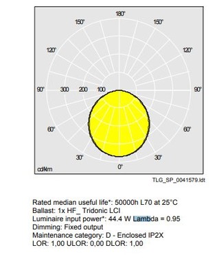

I have an 60W LED which says lambda=0.95. What this specification says? Is it wavelength or something?

Did you look up the manufacturer's datasheet? Since you don't provide any units with this number (angle, um, °C, etc.) it could be any of a variety of dimensionless values. Since this number is less than but close to 1, I'll guess this is an efficiency value thus when consuming 60W of electric power, 3W will be dissipated as heat.

I'm pretty sure that Lambda is power factor.
Harmonic distortion indicators - Power factor
HomePower harmonics managementEssential indicators of harmonic distortion and measurement principlesHarmonic distortion indicators - Power factor
The power factor λ is the ratio of the active power P (kW) to the apparent power S (kVA). See Chapter Power Factor Correction.
{\displaystyle \lambda ={\frac {P(kW)}{S(kVA)}}}
The Power Factor must not be mixed-up with the Displacement Power Factor (cos φ), relative to fundamental signals only.
As the apparent power is calculated from the r.m.s. values, the Power Factor integrates voltage and current distortion.

Full specification given below:
IP67, IK07, power factor-0.9, system efficiency-85lm/w, 60W, 5700K, Philips- BVP161 LED60/CW, 220-240V, ta-35°C, lambda-0.95 (no unit), 0.29A.
