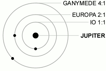

The inner 3 moons, Io, Europa, and Ganymede are in a 4:2:1 orbital resonance. The 4th large moon, Callisto is in a resonance of 5:12 resonance with Ganymede.
So after 83.5 days, Callisto orbits 5 times, Ganymede 12 times, Europa 24 times, and Io 48 times and the 4 moons are back in their original positions. (I guess we would have to wait 167 days to see that, since every other one would occur in the daytime.)
