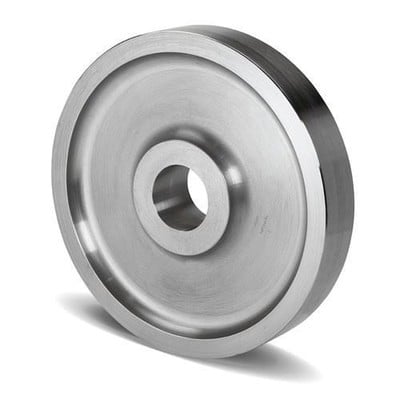

Previous in Forum: Elastic Elements for Damping   Next in Forum: Emails Missing
7 comments
Join Date: Nov 2014
Posts: 24
Gear Blank Dataset
05/26/2021 11:40 AM
I want to do data analysis and build mathematical model with the help of machine learning. I try to find various sources to download Gear blank dataset but i couldn't find any. if anyone help me to give suggestions .I would like that very much.
Re: Gear Blank Dataset
05/26/2021 1:29 PM
Join Date: Nov 2014
Posts: 24
Re: Gear Blank Dataset
05/26/2021 1:47 PM
Thanks for replying
I want to build a machine learning model or api and integrated these machine learning model or api to automatically visual inspection software. These model help me to find various defect on Gear blank such as crack ,dent, forging etc. manually It take a lot of time to inspect the part.but applying theses technology I will save my time and money as well.
Re: Gear Blank Dataset
05/26/2021 1:51 PM
The linked article above explains the process...
Join Date: Nov 2014
Posts: 24
Re: Gear Blank Dataset
05/26/2021 2:10 PM
I know the process. But I just want to download image dataset of Gear blank at least 500-1000 image should be there. And these images have defect.
Re: Gear Blank Dataset
05/26/2021 2:50 PM
Wouldn't your model be of a perfect gear, and any variance rejected, subject to closer inspection?
https://gearsolutions.com/community/
Join Date: Nov 2014
Posts: 24
Re: Gear Blank Dataset
06/07/2021 2:25 AM
Thanks for replying, My model is Ideal or not it depends upon accuracy.and one more question i want to ask you if my model give me outcomes either 0 or 1 and I want to send and receive 0 ->(No) and 1->(yes) value from my computer to hardware via serial port.how I send this value into hardware.
Re: Gear Blank Dataset
06/07/2021 1:50 PM
Register to Reply 7 comments
Previous in Forum: Elastic Elements for Damping   Next in Forum: Emails Missing
