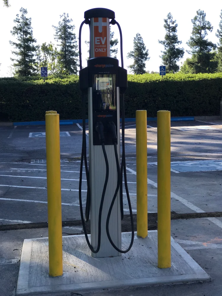

We (HOA) will be installing two CT4021 EV Chargers on ChargePoint-specified 2’x2’x2’ “blocks” of concrete. To integrate a pole for lighting, the plan is to imbed ~15” of a 10-foot length of galvanized pipe or rigid conduit at the back of the concrete block. The stackup of dimensions/geometry dictate that the rear edge of the lightpole be located 2” inboard of the back face of the concrete block (see sketch).
I was concerned that any slight flexing of the lightpole where it exits the concrete could cause a failure at the back face of the block. To circumvent this, we decided to add (weld on) a bent length of #3 re-bar near (2” down from) the top face of the concrete block.
Q1. Does this seem like a practical solution to prevent a crack due to pole flex?
Q2. Would an additional wrapping of the top 2” of the imbedded lightpole with foam tape (see enlarged detail in the side view) be of any value in absorbing any flex that might occur?

The luminaire weighs 3.75 lbs. it’s cantilevered off of a 12” pipe nipple, coupled to the “mast” via a pipe elbow (see sketch).
Yes, I’m aware of the difference between pipe and conduit, that’s why we’re using pipe (cheaper and possibly stronger). I listed both to tamp down comments about running wires through pipe.
I didn’t mention them, so unsure about the relevance of your bollards comment.

Don’t know why aluminum would have any great advantage, but costs are a consideration, hence the galvanized pipe. Same for the “extended pad,” plus a slight slope makes a further extension problematic.
There will be bollards (separately supported and in front) they’re just not shown, and not relevant to my questions.

ACI indicates 3 inches of cover over reinforcement is required if the concrete is cast against earth. Precast requires less cover for reinforcement protection.
The designer is looking at two issues...protection of the reinforcement metal from ground moisture and a possible tension failure in the concrete if something hits the light pole.
Hence bollards would be recommended (as indicated by Solar Eagle). The suggested reinforcement should help prevent a tension failure. I personally would not place the reinforcement bar against your light pole.
First, the interface of the pole and the concrete is a direct path for moisture to get to the reinforcement. Not right away. But, in time it will. Then, in time, reinforcement will corrode, hence expand, and hence crack your concrete.
Second, Zinc and bare steel are dissimilar metals.
Read the following:
Zinc, which comprises the hot-dip galvanized coating is very high on the Galvanic Series (right), which means it will be anodic to most other metals. So, when hot-dip galvanizing is connected to other metals, the zinc coating will not only sacrifice itself to protect the underlying base steel, but also try to protect the other connected metals. This will lead to a more rapid consumption of the zinc coating, and decrease the overall life.
When it comes to bridge design, the most common other metals that may come in contact with the steel are likely painted (bare) steel, weathering steel, and stainless steel. It would not be recommended to connect bare steel to galvanized steel, as the zinc will want to protect all of the carbon steel and the overall coating performance life will be decreased. However, if the other steel surfaces are painted or isolated with a non-conductive material, these connections will not significantly decrease the life of the galvanized coating as long as the paint or isolating materials are maintained over the coating lifetime.
So, in my opinion, your concrete block needs to be bigger to provide cover over the suggested reinforcement on all sides, not just the side cast against the exterior surface.
Based on that, consider a separate light pole foundation for the light. You may save on the cost.

The rebar would certainly add strength to the pole, but I would much rather see the pole closer to the middle of the block and preferably in the middle. I'm not familiar with the codes for this, but I would think 6" would be the minimum. If you do weld it, grind off the zinc coating first. I would not use the foam tape, as concrete will bond to the metal pipe. However, moisture will penetrate the concrete, so eventually the pipe will rust away. An oil spray will help in that regard.

This has long since been resolved (using Bega manufactured light-poles), but thanks, anyway . . .
BTW - light-poles are behind the charging stations, which will be protected by 3-inch pipe bollards.
