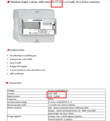

Hello everyone,
I have 300/5A current tranformers, so I chose kWh meter for CT 5A. But, in datasheet writes, current:0,25-80A, Rated current 0,25-5(80A). What does this 80A means? Whould this kWh meter be undersized because I have 300/5A? Datasheet is
attached.

Data sheet here
https://image.schrackcdn.com/datenblaetter/h_mgdizx06-x_en.pdf
More detailed general data sheet here
https://image.schrackcdn.com/bedienungsanleitungen/a_mgdizxxx--_en.pdf
I notice that the Schrack Info includes the line "Current-transformer-ratio adjustable on site"
I wonder if you can find one with "Rated current 0,25-5(300)A" OR maybe "Rated current 0,25-5(400)A " in the Info,
Or of course you could just adjust the output reading "manually" or by software in whatever the data output is connected to.
It means 80 amps in the line produces 5 amps from the CT. In other words, the CT secondary has 16 turns resulting in a 1/16 current ratio.
Would this kWh meter be undersized because I have 300/5A?
If you just use the 300/5 in place of the 80/5 CT, the kWh reading will be 80/300 of the true value.
(As Randall has noted, the datasheet alludes to an adjustment for CT ratio. You might want to investigate that.)

It means that the meter can withstand up to 80 amperes on the meter circuit. The meter is designed to be used as a primary metering device as well as secondary, using current transformers.

I thought so, you just confirmed my opinion. Thx a lot!!

From my meter testing days the rating brackets meant the maximum current the meter could handle without going out of tolerance, eg 5-20A, 10-80A, 10-100A so the meters nominal 100% current is the first figure and the second one is the over range current where the meter is still within nominated values.
The meters were tested at, nominal current 1.0 PF, nominal current 0.5PF, low start current ~12W and the nominal over range current. The meters readings were compared with a calibrated standard meter.
