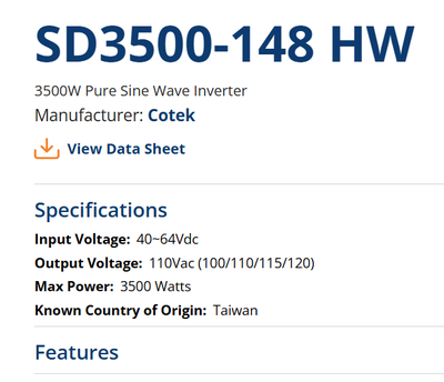

I found this inverter below that seems like it would fit the bill and allow a full sized concentrator to be mounted on your golf cart.

Would you tell us about the proposed golf cart?
The reason for this question is, the 56 volt seems to be pretty unusual, uncommon. One example that I had a look at is the E-Z-Go Liberty.
The spartan spec sheet I could find at the manufacturers website tells me that the battery is a 56.7 volt unit, but the cart itself is 48 volt. So, the cart electronics management system apparently has an internal down buck converter built in!
https://ezgo.txtsv.com/personal/models/liberty/specs/7084
If my understanding of this is correct, and if your selected cart is a similar engineering, you now have a simple solution.
A 1000 watt 48 VDC to 120 VAC inverter is a pretty common device; a popular e-commerce entity shows dozens of available models.

You are right. I misstated what I wanted. I need to convert 56 VDC to 120VAC.

Similarly, I would be surprised if a a 48VDC to 120 VAC inverter was not able to handle 56V.
