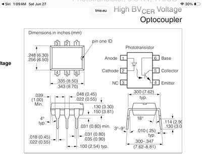

I have an electromagnetic flowmeter that has an active pulse output per unit flow.(High Level= 5-15vdc max 250 mA, low level <1vdc). My chemical metering pump cannot accept an active output pulse, it needs the pulse to be generated by its own dc power supply.Is there an easy way to make this conversion, other than with a 15vdc relay?

An opto coupler such as an H11D3 that comes in an 6 pin DIP package will require at least a small resistor to limit the LED current. But otherwise might be applied directly.

The opto coupler sounds like just what I need, could you provide a connection diagram? Thanks.

To be sure the npn output transistor is rated ok, we should know the voltage & current of the VFD input. Also the voltage & current of the flow meter output, to select the current limiting resistor for the LED input.

To clarify the installation is a mag flowmeter sending a pulse to a chemical metering pump which then meters the correct amount of peroxide into the water according to the number of pulses. The flowmeter does also have an analog output, but the metering pump only has a pulse input.
The magmeter output is rated at 24vdc @ 250mA, the pulse input on the pump is also 24vdc @ 20mA.

Assuming your controller needs about 20mA of current to detect a pulse, you will need to drive the LED at about 20mA. Connect a 1200 ohm 1/2 watt resistor to Pin 1 of the IC. The resistor and Pin 2 connect to your mag meter output. If the ON duty cycle is likely to be more than 50%, make it a 1 watt resistor.
Pin 5 connects to the positive side of the VFD input module. Pin 4 connects to the return for the VFD input.
At these voltage levels, you really don’t need to worry about lead length and routing, normal industrial wiring methods will work fine.
If the output transistor doesn’t provide enough current to trigger the VFD input, you can go with a higher current into the LED, up to 60MA.
A 1000 ohm resistor will give you 24 mA, you will want a 1 watt resistor in that case.

This module is what I'm going to order, that is exactly what I need. I'll let yopu know how it works out. Thanks for the help.
