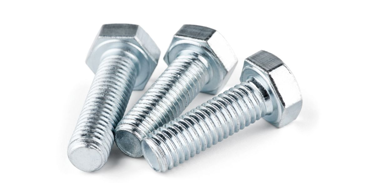

Fully Threaded Bolts
  • Structural Characteristics: The threads start from the very tip of the bolt (tail/point) and run continuously all the way to the under-head bearing surface. These bolts lack an unthreaded shank, meaning the cross-sectional area remains entirely uniform throughout the length of the stud.

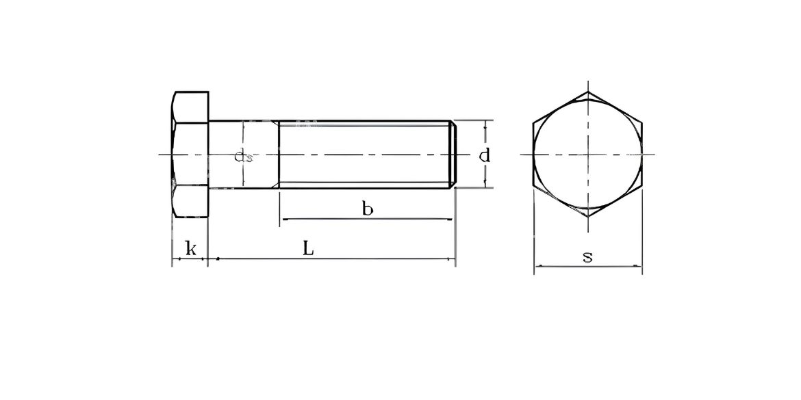

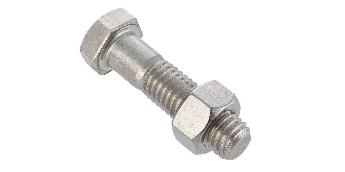

Partially Threaded Bolts
  • Precise Structural Characteristics: The bolt body consists of two distinct segments: a smooth, unthreaded portion near the head (the shank) and a threaded segment at the tip (thread length). Technical drawings focus on two critical geometric concepts here:
    • Grip Length (lg): The distance from the under-head bearing surface to the very first full thread, which generally corresponds to the combined thickness of the joined components.
    • Thread Run-out: The transitional area where the smooth shank meets the threaded section. Due to the sudden geometric change, this zone is highly prone to stress concentration under operational loads.

  1. Fully Threaded Bolts
  • Key Benefits:
    • High Adjustability & Precise Fastening: Since the threads run the full length of the bolt, the nut can be tightened at any position, accommodating a much wider range of material thicknesses.
    • Superior Grip & Load Distribution: The extensive contact area between the threads and the mating components allows tensile loads to be distributed more evenly across the entire joint structure.
  • Technical Limitations:
    • High Insertion Resistance: If the clearance holes of the mating parts are tight, the continuous threads will generate significant frictional resistance when passing through, slowing down insertion.
    • Lower Lateral Shear Strength: The cross-sectional area at the thread roots is inherently smaller. When subjected to lateral (sideway) forces, these roots act as stress concentration points, making fully threaded bolts weaker in shear than partially threaded ones.
  1. Partially Threaded Bolts
  • Key Benefits:
    • Maximum Shear & Tensile Strength: The smooth, unthreaded shank features a larger cross-sectional area, allowing it to withstand extreme lateral shear forces and heavy tensile loads with a much lower risk of shearing off or fracturing.
    • Smooth & Fast Installation: The smooth shank slides through clearance holes effortlessly without catching on the edges, significantly boosting assembly efficiency on production lines.
    • Challenging Selection & Low Tolerance for Error: Sourcing requires extreme precision. You must choose a bolt with a grip length that exactly matches the total thickness of your mating components.
    • Rigid Precision Requirements: This is a classic “one-size-fits-all does not apply” scenario. If a measurement error leads to a shank that is too long, the nut will bottom out at the thread run-out before clamping the materials together, resulting in a loose and failed joint connection.
Differences in Measurement Methods
  • Fully threaded bolts only require measuring the total length of the bolt body (the entire length excluding the head), thread diameter (major diameter), width across flats of the head, and head thickness.
  • Partially Threaded Bolts: In addition to the aforementioned dimensions, the thread length (b) and the smooth, unthreaded shank length must also be measured. Furthermore, for special “full-size shanks” (shank diameter = major thread diameter) or “reduced/waisted shanks” (shank diameter < major thread diameter), the actual diameter of the unthreaded shank portion must be precisely measured.
Additionally, the thread type must be determined—whether it is a coarse thread, fine thread, or a special trapezoidal thread.
Thread Length Calculation Formulas for Partially Threaded Bolts
In fastener manufacturing and international standards, the actual thread length (b) of a partially threaded bolt is not determined arbitrarily. Instead, it is strictly calculated based on the total bolt length (L) and the nominal thread diameter (d) across three distinct dimensional ranges:
Bolt Total Length (L) RangeThread Length (b) FormulaEngineering Intent
Short Lengths: L ≤ 125mmb = 2d + 6Ensures optimal grip rigidity for shorter fasteners.
Medium Lengths: 130mm ≤ L ≤ 200mmb = 2d + 12Balances load distribution between the shank and threads.
Long Lengths: L ≥ 220mmb = 2d + 25Provides sufficient thread engagement travel for extra-long joints.
