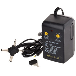

I have a 3 vdc wall adapter and would like to drop the voltage to 1.5 vdc to duplicate a battery. Any ideas
