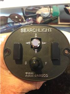

A friend gave me a old 12 V 13´´ ITT Jabsco marine searchlight as a present, that perfectly fits to my vintage trawler. It looks great... and works fine, but the wired control is missing. The light has 2 GE 12 V DC motors (no ID on them) -one for the "X" and another for the "Y" axis movements. transmission is not direct, but through a little gearbox on each, a toothed wheel and a semicircular tooothed sector. I connected each motor to a 12 V source, and the worked. Reversing polarity they did it the other way. I thought of purchasing a joystick as used in some machines, but down here they are by far very expensive. Any ideas for buiding a easy to use DIY control? Kind regards.
Below is an image of a slightly smaller light I just have seen on ebayhttp:

Use two of these, (DPDT centre off, centre biased toggle switch), one for X and one for Y. Supply to common contacts, motor "+ve" to diagonal opposites, motor "-VE" to other contacts.

Greetings r&ddoc,
As a fellow mariner I can appreciate the new addition to your trawler.
Building a controller yourself is probably the most economic way to go.
As a side thought have you searched Google for a replacement joystick?
You may not have to do any modifications if you do buy a joystick and if you do, they will be minimal at worst.
Only drawback may be shipping but the joysticks like the one below are only about 10 oz.
In addition, any boat junk yards in your local? You may find an inexpensive used one there.
Here is a common wiring scheme for the older Jabsco line;

Hi kramarat, my knowledge in electronics is near to zero. Should I get such joysticks and connect them to the x / y motors using contactors?

No, you won't need contactors. The two I worked on were wired directly. The other suggestions, while feasible will not be water resistant. If you go the switch route, you will have to spend some quality time with your local electric supply house. The wiring is straight forward, but you may need to crimp/solder. Your local boat yard may be able to help, another possibility is a radio repair shop (as in police/taxi radios. They will have the tools and expertise. It may cost you a fishing trip etc.

Basically you need two SPDT switches, one for up and down, the other for left, right. These should be center off, with springs to return to center. The original was a joystick affair. As Jabsco is still in business, I would send them an e-mail. The unit you may be referring to, dual filament bulbs, is still in production.

I would save a bundle by simply buying two switches...and use a tin can to mount them on.
The ones that toggle up, centre off and down.
Power goes into the centre terminals, and leaves by the end terminals.
Put them so that the switches are up and down for the "up and down" and sideways for the side to side movement. You already know which wires drive which motors, just hook them up as I explained.

Hi Jimrat, You earned a + vote from me! Your idea is excellent,, but it may require to cut some square holes to fix them to the board (which may be tricky). BUT this led me to another idea. I will get 4 panel mount round push buttons (it´s just a single hole) and a switch. They can be arranged forming a cross with the power switch in the centre: by pressing one button (up / down), there will be a single motion. If (R or L) are pushed simultaneously, panning will also be possible.

Think you'll find that if R & L are pressed simultaneously, you'll blow a fuse (if fitted; if no fuse you'll burn out the wiring - and maybe the boat).
Edit - or did you mean e.g. R and U for diagonal motion?

Hi John, Yes, I will use fuses! (they are cheaper than a new boat!). I suppose, the original control system also provided a swift diagonal motion, which I would love to have, but will certainly not achieve using buttons or switches. A more primitive movement like turning to the right + downwards (or the opposite) should be possible pushing two buttons (or switches) at the same time. Kind regards!

(Too late to edit, but) You'll still need double-pole switching, for the reversing action, and the point about R & L (or U and D) together causing damage still holds - which is why I suggested changeover switches)
