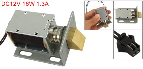

Re: Screw Type Linear Motion? Stepper Motor?
09/03/2015 4:36 PM
Linear actuator solenoid?
Hobbies - CNC - New Member
Location: Lost Wages Nevada
Posts: 1578
09/03/2015 5:06 PM
He said he tried a solenoid but it did not have the force required!
I know he could try a different one but he is working with 12 VDC R/C controllers and it may not have the available current needed to push a heavy magnet?
Location: South east U.K.
Posts: 3698
Good Answers: 94
09/04/2015 4:58 AM
He quoted 7 lbf, the one I linked to gives 9.9 lbf.
Posts: 1578
09/04/2015 9:47 AM
I stand corrected. I do know that it takes a bit of current to get those solenoids to fully actuate.
I don't think he has the needed current available with the R/C equipment!
Posts: 3698
Good Answers: 94
09/04/2015 9:55 AM
The supplier states 400mA, I don't know if that's high from the point of view of R/C stuff.
