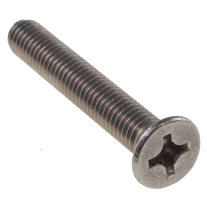

First of all, I am a high school student so I am not an engineer yet. Me and my group are supposed to solve other problems (which we already did) but cannot figure this one out.
We will turn the torque setting down to see if it works.(Thanks for the suggestion)
Anyways,
Here is some of the information.
The screw is: 302 Stainless Steel, Passivated. M2-1.0 x 6.5mm ± 0.5mm
The hole is: 0.65in
The material is: DUPONT ZYTEL 70G13L

No, does your screw look like the first (correct) screw, which is for plastic?
The second screw is a machine screw and is for metal.

What type of screw are you using, thread forming or thread cutting? The forces involved in driving the screw depend upon the type of thread, the material it is being driven into, and the hole prep. (Sorry I couldn't view your video).
Thread forming screws deform the surrounding material, while thread cutting screws act similar to a tap in that they remove material which has to have some place to go. If it's a blind hole that isn't deep enough to accomodate the removed material then it will halt the forward progress of the screw and it will strip the threads it just cut.
