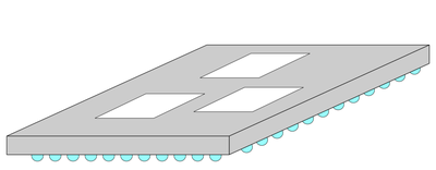

We have doing reballing process. We are doing my SMT Process . In that SMT Process we place solder balls on BGA . In Solder Balls BGA , there is flux contamination to be removed . We able to remove the flux contamination by using MEK and Bioact Chemical . It is getting removed well . But at the same time , in IC top surface on the BGA Polarity side , we are facing White Patches . We unable to clean the white surface , but currently we clean the white surface by using eraser . But it is damaging the balls in BGA.
Need to avoid using rubber or eraser , is there any chemical can be used to clean the white surfaceon the polarity side of the bga , and at the same time it should not affect quality .
pls clarrify and give us the solution.

Are these patches appearing ONLY AFTER the reflow process?
Does it appear like this?

If this is what you're talking about, it's likely something with the package material.
Are you following the heating profile parameters recommended in the IC Datasheet?

Thks for the Reply .
After Reflow Process White patches is not formed .
After Reflow Process flux around the balls is desposited . We need clean them . So that we are using Chemical like MEK and Bioact . After cleaning with the Chemical all flux residues have been cleaned .
after this process by the combination of the chemical there is white patches formed in top of the ic looks like same in the photo you have seen .
how to clean this , pls specify the clean process.

So, I was right, except the patches do not show up until AFTER the cleaning process.
Have you talked with your chip supplier/manufacturer?
It would really help if you posted a photo.

It seems as if the MEK and/or the other cleaning chemical is dissolving some component of the chip package. Does the same happen on the hidden surfaces?
You might try using a water soluble flux, which can be cleaned with water and/or alcohol
