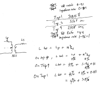

For a furnace transformer of 9 taps primary voltage is 33 kV (Constant). Secondary Taps voltages - MVA -AMP are as follows-
Tap-1: 385V - 24MVA - 36033.3Amp - ?? (%Impedance)
Tap-4: 335V - 24MVA - 41411.4Amp - 8%(Impedance)
Tap-9: 250V - 17.91MVA - 41411.4Amp - ?? (%Impedance)
What will be the value of %Impedance at Tap-1 and Tap-9?

I can not perform the calculation in any way. We have the transformer impedance data at tap-1 and tap-9 from the manufacturer name plate. But can't verify the same.
Please advice me to solve the problem.

The voltage values are no-load voltage as it is given in name plate of the transformer.
We know the no-load and load loss as 30 kW and 175kW respectively.
Is it possible to calculate impedances at various tap position considering the above data?

If the load loss is 175 kW, then this is 175/24000 = 0.0073 per unit (0.73%) of 24000 kW.
The 8% impedance has two components resistive εr and inductive εx at 90 degrees to each other. From geometry of right angle triangle for 8% impedance εz, εz2 = εr2 + εx2,
hence εx2 = εx2 - εr2 = 82 - 0.732 = 63.47 : εx = 7.97%.
Regulation of a transformer loaded at rated VA is εr x cosΦ + εx x sinΦ.
Assuming resistive load [negligible inductance in load] cosΦ = 1, sinΦ = 0, hence regulation is 0.73 x 1 = 0.73% - which is negligible.
Tap 4 is 335 V, Tap 1 is 385V, hence impedance ratio is [385/335]2 = 1.32. Hence impedance on tap 1 is 8%/1.32 = 6.1 % ( on 24000 kVA base).
Similarly, Tap 9 (250V) is 19% on 24000 kVA base.
I am assuming taps are actually on the HV winding and magnetic coupling is uniform, in the absence of any specific data.
Note that the tolerance on impedance is usually +/- 20% on nominal nameplate values.
The impedance is of relevance to the HV loading, as calculated above its effect on secondary with rated resistive load is negligible.

For furnace application power factor of the load at Tap-1 is nearly 0.15 and at Tap-9 it will be around 0.85. Also, the transformer is not constant flux i.e. constant MVA mode of operation from TAP-1 to TAP-9.
Constant MVA is from Tap-1 to Tap-4 i.e. 24MVA. From Tap-5 to Tap-9, it is constant current mode of operation i.e. 41411.4 Amp.
Your calculation for Tap-1 is almost as the name plate value but Tap-9 is far from the declared value of 12%.
Please advice on this matter.

If the Tap 9 impedance is declared on an 18 MVA base rating as 12%, then on 24 MVA base (as I calculated it) it would become 12% x 24/18 = 16%.
Unfortunately, engineers can get so used to putting down figures in the way they habitually use - they forget to put in the base assumptions like the kVA base for an impedance. For example, whether value was mean, root-mean-square, peak or peak to peak [an omission often made when quoting vibration amplitudes].
Myself, if a transfo had multiple ratings, I would "spell it out", word by word, what base applied to each impedance, with a preference for giving all on the same base.
Usually, a necessary step in a system analysis is to get all the impedances numbered on the same base kVA, their relative effect is better shown.
The calculation I did assumed
a) all the impedance is in the secondary.
b) a perfect transformer with zero resistance and leakage reactance is between source and secondary impedance.
In reality, the reactance will be divided between primary and secondary (make them Lp and Ls, respectively). I sketch below the effect of assuming half being in primary and half in secondary, all on 24MVA base at primary voltage.
Of course, this does not include the difference in primary leakage reactance due to the different number of primary turns with change of tap (and resistance is ignored, as insignificant).
