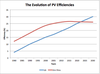

Below is a graph displaying the reducing prices for PVs since the late 70's. That's a reduction of better than 100 times, and allowing for inflation over that period, it's even better than that.
Chinese manufacturing has been the big driver in getting these prices so low.
It's now to a point where PV self generated electricity is cheaper than grid power, we're now just waiting for the cost of storage to catch up - or down.
As for efficiency improvements, the below graph says it all.

As of 2016, it's approximately $3.00 per watt, installed. A 10kw system is around $30K installed....still not cheap...and well beyond the average persons ability to purchase....and not a good investment when you consider the monthly cost of grid to be ~$150....that's 200 months to break even, not considering maintenance costs and assuming total energy needs being met by the pv system....Probably can assume a 30 year break even time frame...about the time you need to replace everything....They need to hit $.50 per watt installed for most people to consider it.....
