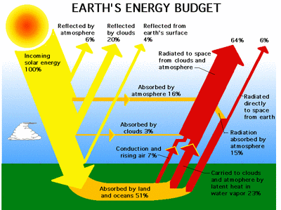

Have a look at the below graphic and tell me what you see.
This is the Energy budget for our Earth.
What do I read from this graphic?:
1. There is no energy transfer from the atmosphere to the surface. This is actually supported in all diagrams that show the back radiation, which always is less than the radiation from the surface to the atmosphere. The atmosphere cools Earth surface – takes energy away.
2. Latent Heat is the number one Energy transfer form from the surface. (you can crunch the number in the diagram)
3. The Energy budget is 100%. It seems to be agreed that what comes in goes out. This alone makes us entirely dependent on what the sun delivers. If we believe that the sun delivers the same energy to the system Earth and we lose it equally, then it means that Earth can neither warm nor cool. Only a change in energy supplied by the sun can change the energy content in the system Earth. Independent to this is the possibility of a different energy distribution on Earth. But it also means that when something else gets warmer another part must get colder.
4. Last but not least I see that our atmosphere radiates a whopping 64% of the Energy away from Earth. I am asking two questions:
a) what enables the atmosphere to radiate? The answer to this is easy – The so called Greenhouse gases. They absorb energy the same way as they can emit.
b) What happens without these gases? Lets answer this just with the information from the graphic – 64% of the energy that Earth receives could not be radiated away from Earth from the atmosphere – kind of trapping the energy in the atmosphere!
My take from the graphic with normal physical logic applied is, that CO2 is part of the atmospheric cooling mechanism.
Want to debate how an Earth without Greenhouse gases would be looking like?
Please stay away from political rants. This is supposed to be about the physics and a graphic from NASA which took me way too long to find.

The thing I don't get from the chart, is where the other 30% of incident radiation is going. I only count 70% back out into space, on but wait, that other 30% never made it to the surface to begin with. OK, now I get it.
The earth receives 100%, of which 30% is immediately kicked out.
Of the 70% received at the surface, all 70% is eventually radiated back out.

The sun's power hitting the earth is about 174000 TW.
https://en.wikipedia.org/wiki/Solar_energy
Average power generated by humans (2013) is about 12.3 TW, not all of which is due to combustion of fossil fuels.
https://en.wikipedia.org/wiki/World_energy_consumption

I see an overly gross simplification of a very complicated process.
With 100% of the Sun's energy reaching the Earth being re-radiated or reflected back into space this diagram implies an equilibrium condition. However, nowhere in this diagram is the energy needed to sustain life on Earth. I'm sure we all will agree that plants convert sunlight energy into chemical energy that is considered food to the entire rest of the Earth's ecosystem. It is very plausible that this tiny fraction of stored energy is smaller than the 1% resolution of this diagram. Similarly the solar energy converted into the storms found on our planet and how this energy has carved and etched our landscape by wind and water erosion cannot be found anywhere in this simplified diagram.
I also see from this diagram a strong desires for simple answers.
I thought this place was for engineers.

The problem with this graphic is that the time factor is missing, and variable I might add....Though the heat reaching the surface may all eventually be irradiated back into space, how long it lingers on the surface could be catastrophic....I can go lay out on the beach, and come back home at some point....the amount of sunburn can be nothing to 3rd degree burns depending on the time factor....
Re: A Simple Minded Evaluation
11/04/2016 12:50 PM
Yes that's where Thermodynamic comes in.
An average temperature is meaning less as well, if you think that you can find a night temperature that compensates for 100 deg C day temperatures to maintain 15 deg C average temperature on Earth.

You are missing the point that if the surface would have to radiate the same energy away that the atmosphere does, it would have to be much hotter than it currently is.
There is no feedback loop in the diagram and the sun is the only source of energy.
The short comings of the graphic are clear but the quality of the anwers we get from it is not affected.

Yes, the Earth's atmosphere does perform most of the radiation cooling of this planet. Good for us. My point seems to be lost in these discussions.
The average temperature of the Earth is 57 °F, aka 14°C, aka 287K. (We can quibble all day on the exact value.) Temperature has a linear relationship to the average thermal energy of an object if one uses an absolute temperature scale. A change in a 1°C value is actually a change in about 0.35% change in energy. A 1% energy exchange resolution means one will still be clueless why a 1°C change has happened.
Re: A Simple Evaluation
11/04/2016 2:53 PM
Temperature may have a linear relationship with average thermal energy, but that isn't the important relationship that drives temperature in this system.
If less heat is being radiated away or (otherwise removed) than is being input, temperature rises until heat removed and heat input are balanced.
Stefan-Boltzmann law provides a decent place to start; blackbody radiation being proportional to the 4th power of thermodynamic temperature. This suggests a temperature increase from 300 K to 301 K should cause more than a 1% increase in blackbody radiation.

But Stephan-Boltzman law gives one the total black body radiation (energy) per unit of surface area not the total black body radiation of the body. This works very well with a solid or liquid body. We've established from this simplistic diagram that the atmosphere is the dominant radiator to space. What is the total surface area of the atmosphere? I expect that it would be larger but how much larger.
As I said before, this is an overly simplified diagram to a very complex topic.
