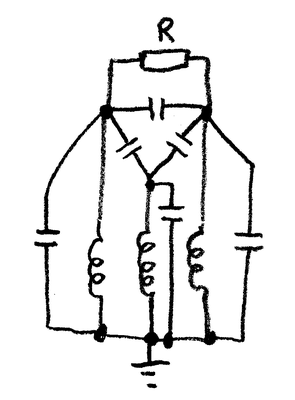

From your description, you have an ungrounded 3 wire 6 kV system. This is often applied on a small system as a necessity to keep cost down. A single ground can be tolerated for a time, if a "tree branch" it can even be cleared without disconnecting anyone. There is the problem that the location of a fault is untraceable, except by opening each feeder in turn, until the one with a fault is opened. There is insufficient current into an earth fault to operate feeder earth current relays.
There are reasons why any large size system is earthed, directly or by a resistance. The use of earth current relays to disconnect only the faulty circuit quickly and automatically is one.
Another is the build-up of capacitance to ground as the system grows. Eventually, this can get to a size which resonates with PT primary inductance at power frequencies. In effect, the resonance increases the impedance to ground, Inductance is "tuned out" by capacitance [parallel inductance and capacitance at resonance ideally have, with zero losses, infinite impedance].
This increased impedance gives greater voltages for any given injection of charge by switching or lightning/faults and leads to overvoltage of PTs and their sudden failure. The "killer" is usually an arcing ground fault which causes many more spikes than less frequent switching/lightning events.
The Δ capacitances line to line and Y capacitances to ground are interconnected, so resistance load across the Δ capacitors does have a damping effect on resonances to ground.
The sketch shows the PT primary inductances and the capacitances, with one load resistance.
Note that if the magnetising power of one primary of the PT is 50 VA at 4000V, the magnetising current is 0.0125 amps. At 4000V 50 Hz, a capacitance of 0.01 microfarad is 320000 ohms, which draws 0.0125 amps, compensating the inductive current, theoretically giving exceedingly high impedance to ground at 50 Hz.

The point is that, by transformer action, an LV winding resistive load on PT adds resistance to ground on the 6 kV system. You have written that when you load the 6kV system, by turning on a site load, the fluctuating reading becomes steady. If you load all 3 phases by loading all three "line to ground" PTs, this will give maximum damping of any resonances.
My impression is (you have not given any details of grid transformer rating or current demand of your load) that you have a delta transformer winding connected by a short length of 6 kV open wire line to your system (on which your load breakers are open when you have fluctuating readings).
This 6kV system would appear to have very high impedance to ground. It is ungrounded except by the PTs. As I pointed out, with electronic relays the load on the PTs may be very small - also that ungrounded systems can have have high resonance voltages.
I cannot see the diagrams of the loads on your PTs, nor can I see what other loads are on the PT which might affect the relay from which you are taking voltage readings. Neither can I disconnect equipment which might interfere with your relay, measure at PT LV terminals direct rather than at relay, or connect an electric toaster or kettle or other available resistive load or see what your relay does, apart from giving voltage readings.
Although a PT fault is possible, loading at 6kV line-line would not affect the "PT to ground" primary voltage. Also, since two other line voltages to ground are indicated "normal", it is not possible the third voltage is not normal in reality.
