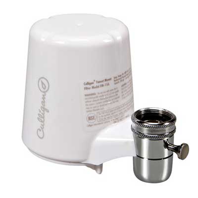

I use a Culligan faucet mounted activated charcoal type filter to remove chlorine taste...

If you want to cook, make coffee tea. etc. with clean tasting well filtered and fresh water the little tap based systems are woefully inadequate.
More than one filter type can be ganged into a setup like this one for pennies.
Solar.. I'd give this a strong consideration next time you're at the tap. You need to set a timer to get a potful of water from those little ones on the tap head.
The big filters cost less and will filter 10-40K gallons over 2/400G for the one on the tap.

I'm in no hurry....I've used these for years, they work well and are cheap....Adequate for drinking water and coffee....I pre-fill plastic water bottles and keep them in the refrigerator, after a drink, a quick top-off and bottle switch = constant cold water supply with minimum refill time....no more than three seconds...coffee pot maybe 20 seconds for 6 cups....Takes that long to grind the beans anyway....
