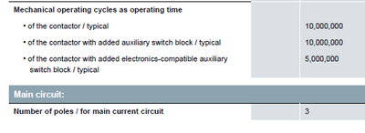

That contactor has no auxiliary contacts - the specs on the link you provided indicate that there are no included auxiliary contacts on that particular device and is 3 pole only, so I would take that as being correct.
If you need auxiliaries, then you would fit an auxiliary contact block to achieve that. You can get contact blocks for these to fit either on the side (part# 3RH1921-1DA11 with 1 x NO contact) or on the front (part# 3RH1921-1HA11, 13, 22 or 31 with various NO & NC contact configurations) as desired.
Or you could order a 3RT1326-1AL20 which is basically the same device but with 4 poles, and use one of the poles as an auxiliary.
The SRT1025-1AP04 is also a similar rated contactor, is 3 pole with the 3RH1921-1HA22 front contact block pre-installed for an additional set of 2 NO and 2 NC contacts.

Already covered but the link provided by you showed this;-
As you can see it mentions an added auxiliary switch.
