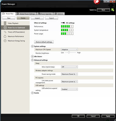

I think maybe I'll take my chances. I mean, the PSU was designed for the M58 to accommodate it's internal and a few external peripherals, right? With a little overhead, I suppose, left over. 19W is not a lot. What blows a PSU--too much amperage?
There should be some kind of utility in Windows10 to tell you about power consumption...wait I just found a Lenovo utility. I guess I buy the card, plug it in and see how it changes what I see currently.

Right. I see. The card reviewer stated 19W. That's ultralow, comparatively, then. If my PCI-e power rail is 12V...1.58A would be the current the card pulls?
I know you guys have no way of seeing what this Lenovo power mngt utility does, but if you zoom in on the pic, it looks like real-time monitoring and protection.
Brownouts? Data corruption? Periodic rebooting? Stress? Rather blow up the PSU. Thanks, gentlemen... I have a better picture now.
