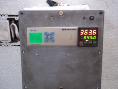

I have a basic Mypin TA4 PID controller I want to set up to do heating only control cycle work and I can't remember how to set one up for variable control operating conditions any more.
The old controller was a relay output and worked well enough for basic on/off control of a heating element to maintain a temperature but had a fair over and undershoot lag to it of about a 15 degree overshoot (~355 F) once it hit the shutoff point (340 F) . After that on cool down it would have about a 20 degree lag (~320 F) before the temperature started picking back up.
I figure that being the new unit has solid state output I should be able to do on the go PWM of the power in proportion to how far off it is from the setpoint to be more stable and cut down on over and under shoot issue.
The basic numbers are I want to set the temperature for 340 F and have the controller start dropping the power back from 100% down less and less as it reaches 340 F then hold near whatever level it needs to keep it there then start gradually ramping it back up as it drops.
So how do I set this damn thing up to start backing off the heater power as it reaches the programed temperature then start proportionally applying it if it starts to fall off and not have a fit if it has to sit for any period of time with process powered down.
Steady on power level is around 60 - 85% and varies as the incoming product (oil) temperature changes hence not being able to just set the heating element at a fixed power level.
System thermal response time is about 300 F per minute at 100% power and about 100 - 150 F per minute falling.

Unfortunately I have already watched and read all of that.
That initial high level oscillation is the problem.
The units is controlling the oil preheater for my used oil burning boiler and if it gets much over 360 F it starts cokeing up (burning) the contaminants inside the preheater unit until it plugs it or the nozzles up hence the wanting the overshoot part of the cycle cut off.
Right now the all or nothing control works well enough but I was just hoping there a some setting I didn't know about on PID control units for quick ramp up at full power (to say 325F ) followed by a tapering back of power until ~340 F is achieved.
So far with the normal PID setup procedures I seem to be hitting 380 - 400 F peak then dropping to under 300 F (too cool to spray and burn right) low every time then having a damped oscillation down to the range I want that takes about half a normal burner heat cycle to stabilize every time the system fires up.

03/04/2017 7:20 PM
The mini boiler. (showing PID overshoot issue with the auto tune settings.)
The controller.
The oil preheater assy.
That's the basics.

Are you using the controller's integral function?
If answer is yes, it looks like your controller is over/under shooting due to "integral windup" that will take place while the oil burner is turned off. Disabling the integral function until oil temperature has entered a controllable region should cure the problem.
Zvi

I was not aware of that so I will give it a shot and see what happens.
It does make sense though. Every time it cycles the burner on the PID starts out with wild swings +- ~ 20 - 25F gradually working its way down to a acceptable range, +- ~ 3 - 5F after about 15 minutes which is about the end of the burner run cycle on a short reheat cycle.
That initial over/under shoot is what I am trying to eliminate.
Re: Simple PID controller setup.
03/05/2017 9:00 PM
I turned it off and it made the thing way more stable right from the get go on every burner cycle start no matter if it sat for 10 minutes or 3 hours since the last cycle!
Worst over and under shoot at first burner startup is less than 10 degrees with a normal variance of about 4 - 6 after that!

Cool setup, great job! Is the 4-6 variance a constant oscillation from your setpoint during burner operation, or does it reach a steady-state temperature and that is just the variation from run to run?
03/26/2017 6:10 PM
Pretty constant. It seem to drift a bit up and down from the set point over long boiler running cycles.
It will stay within +- 2 - 3F for a few heating element cycles then start to drift high or low then come back to the +-2 - 3F variation range again.
So far I have not had to clean out the oil preheater due to coking and plugging issues so far so I am considering it good now.
