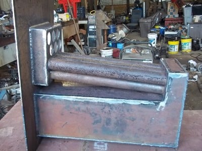

I am sure the regulars here have seen at lest one my numerous posts about my 'Mini Boiler" I built this winter and wondered what sort of mad scientist thing do I have going now.
Well here it is! Pretty much done except for the surge tank!
So what it is is a replacement for my old boiler system that I built some ~15 years ago that last winter finally rusted through bad enough to justify being taken out of service.
That one started out as a wood/coal/garbage/tire/railroad tie/used oil burner that would eat pretty much anything that was flammable and figure out a tolerable burn rate characteristics using a Teco PLR unit like the one I have pictured here.
The new one however was designed to be dedicated used oil only unit. Physically much smaller and overall considerably more fuel efficient on used oil too.
The old one was surprisingly efficient on solid fuels but when I converted it over to run used oil the far smaller burner being physically larger and in a poorly insulated room the ambient thermal losses there were a issue that was largely unnoticeable with the other fuels.
The new one being far smaller has far less thermal losses plus it's also in a well insulated and sealed building now that holds the heat in way better so what heat it does loose now serves a far more gainful purpose for me. Most of the time my new 14' x 20' work shed stays a comfortable 60 - 70 F from it without having to run the floor heat! (but it so nice on the feet when it does turn on!)

So for how it works as you can see it uses a fairly standard fuel oil furnace burner unit but with a bit of modifications to make it work on used oil.
To start out used oil is too thick to go through the tiny injector nozzles those types of burners use so it needs a cheat to thin it out. That cheat is to heat it up to around 340 - 350 degrees Fahrenheit just before it shots out the nozzle.
To do that I designed and developed a special preheater unit that fits in the head of the burner unit.
Its basically a section of 1.25" solid copper bar stock with a 150 watt cartridge heater and thermocouple embedded in one half of it with a 1/2" fine threaded passage in the other half that has a 7/16" solid steel dowel inside it with a sold brass fuel oil burner nozzle holder bushing silver brazed to the end.
Then that has a 350 watt external band type heater around the whole outside that's held in place by two stainless steel band clamps.
The notable thing about the design is that when thick oil passes through a heated passage it apparently tend to create a odd laminating effect where the hot oil on the sides stay put and the cooler oil keeps moving through the center.
So despite having the main body at 350+ F the cold oil entering the heating passage still makes its way to the nozzle still too thick to spray properly causing flame sputter and surging.
By adding the dowel that closes the passage down it keeps the oil flow out on the edges of the passage where the threaded surface breaks up the laminating flow effect so the oil gets evenly heated before it gets to the nozzle.
It took me a good long three days and half a dozen or so redesigns of the preheater passage way to figure that little detail out.

As for its construction it made mostly from 1/4" steel sheet with 2" schedule 40 pipe for the flues.
The firebox is ~10" x 10" x 30" ID. It works okay but after having had it in continuous operation for two months and ~ 500 gallons of used oil I have found that I should have made it larger.
The old boiler had a huge 20" x 20" x 54" firebox that could hold 2 - 3 five gallon buckets of ash without a problem but this tiny one doesn't have much space to spare and used oil makes a lot of ash due to its zinc and other micro solid additives and contaminants. ~ .5 - 1% by volume of used oil is actually microscopic solids that do not burn and leave a very fine dull grey/white rusty soot powder behind.
Given with the old boiler between the large burner box volume and the fact I regularly tossed shop garbage and old wood bits in it I never thought much about how much of the ash came from that stuff or the used oid residues. Turns out way more of the ash was from the oil than the other stuff.
At this point due to the ash issues plus the small dimensions of the firebox and flues limiting the amount of burner capacity I can run at without getting flame fluttering and blowback effects due to draft rate limitations I may take the whole thing apart and redo that part next summer or fall some time and expand them to open things up more.
Right now I am thinking I may open it up the firebox to 12" wide by 14" high and convert the flue system over from the 12 tube design (6 forward pass 6 backpass) to a open dual 2.5" x 12" box layout. The overall heated surface area will stay about the same in the change but it will make the draft flow better plus give me more ash management room.
Water jacket capacity wise as it is presently designed it holds ~ 90 gallons and uses two small pumps. One is a Taco #9 that sends ~ 6 GPM to the house and the other is a Grundfos UP 15-42 set on low speed that puts about 3 - 4 GPM to the shed floor circuit.

The control system is designed around SG2-20HR-D Teco PLR (Programmable Logic Relay), a simpler low cost PLC of sorts, (still runs circles around most 1980's and 90's PLC tech though!)
Teco PLR units.
This model is a 24 VDC unit with 8 digital (on/off) inputs, 4 analog 0 -10 volt inputs and 8 digital relay outputs which for most DIY project work is pretty convenient to work with. Especially given its fairly robustly built and ruggedized making it able to handle some pretty rough environmental applications that any home built uC device based control system would take a lot of additional parts and work to get up to handling and working as a near plug and play setup.
This one is one of the earlier V2 models that did not have the programing capacity for doing dedicated temperature sensor inputs or any degree of PID loop control (at least not easily and not with this model anyway) so I had to do a bit of cheating to make it work.
I used a basic PT100 converter/transmitter module that takes the PT100 sensor signal and converts it into a 0 - 10 volt signal that this PLR's analog input system works with.
Also for the burner unit I use a bit of a cheat for flame detection as well. I pull off the 24 VDC power and run that through a 1.5K resistor then through a 50 - 5000 ohm CAD cell then back through a 1K resistor to ground that has a 1000 uf capacitor across it to stabilize the voltage signal. By using one of the PLR analog inputs to read the point between the CAD cell and the 1K resistor for the flame detect signal it can see if there is a problem with the burner.
With that a proper burning flame reads about 6 - 7 volts and a weak flame is less than 3 volts which at that point the PLR knows that the nozzle is plugging up or there is a oil quality issue (water most often) and shuts the burner down if it doesn't go away after 20 seconds. Simple effective burner monitoring and safety interlock.
Now as for the oil feed that comes from a 550 gallon tank that sits beside the shed. Given that our winters get way cold and -30 F is an expected low every year I set the system up with 3/4" steel pipe for the oil feed and have it passing right beside the back of the boiler to help heat it up before it gets to the filter.
For the filter I used a common Omni whole house water filter unit (blue thing on the wall) with a basic mesh type sediment screen. Unfortunately at 100 mesh the screen is too coarse to catch the fine debris in the oil and the next available filter they have is a 50 micron which catches too much and plugs up way too fast plus at ~ $3 - $4 each they cost to much for my cheap ass to be replacing every week or less.
My surprisingly effective and dirt cheap solution to the filtering problem was to simply wrap the mesh screen sediment filter in 2 - 3 layers of common paper towels. Perfect filtering range plus costs nothing! Also there is a vacuum switch on the filter system that sends a signal to the PLR telling it if the filter gets plugged up. At ~ -7 PSI it shuts the burner down.
For general service since it needs the flues and firebox cleaned out every week and being that the burner nozzles do plug up now and then the whole burner unit is mounted on a steel plate that's held in place by wing nuts. Plus the wiring is through a Amphenol multi pin plug and the oil supply is connected to the filter though a Pioneer hydraulic coupler so the whole burner assy can be disconnected and taken off or put back on in about 30 seconds.

One of the other minor issues I had with the design was that initially I placed the boiler on a 2" thick piece of extruded polystyrene insulation to help keep the heat from the base of the boiler from heat soaking and possibly cracking the concrete under it.
The problem I found was then exposed to oil polystyrene insulation board starts to decompose!
When I had the boiler out to do the feedline replacement I found that about 1/3 of the insulation panel had decomposed into nothing but dirty pink slime from oil exposure due to several times where the nozzle plugged up to the point it would not spray yet it would still pass oil at a much slower rate thus filling the firebox with enough oil to leak out onto the floor. (main reason the flame detection system was added.)
On the reinstall I made the new base out of 3" x 4" oak which by the IR thermometer is providing more than sufficient thermal separation distance between the boiler base and concrete.
Another issue was with the control system design regarding the oil preheater control.
Being the Teco PLR unit i have cant work directly with thermocouple signals plus has limited programing capacity for handling more complex analog work I simplified its job by adding the dedicated Mypin TA4 PID controller to the system to handle that function.
That's how the old boiler system oil burner add on was done and it worked well so it made for a justifiable carry over onto this one. Plus being a dedicated control systems it's way easier to make adjustments to as well.
When the boiler temperature is below operating range (<180F on, >195F off) the PLR activates a relay that send power to the PID's SSR.
From there if the PID sees that the oil preheater is below operating temperature it activates the SSR. Plus if the preheater is more than 20 degrees cooler than its set for it activates its alarm output which sends a signal back to the PLR unit telling it not to run the burner.
As long as that standby signal is active the PLR does not start the burner or the flame detect time out functions. If however when the PID tells it it can start the burner if the flame detect does not see a sufficient flame signal in 5 seconds it stops the burner then waits 10 seconds and tries again.
It will do this 4 times in an attempt to clear a partially plugged nozzle before locking the burner controls and oil preheat functions out and can only be reset manually. Also when that happens it gives me a "Flame detect fault" message on the PLR's screen so that I can see what caused it to shutdown.
There are also other display messages for other actions that the PLR has control over like if it shut down due to a filter related issue or one of the analog inputs going too far out of range.
Mostly it just tells me what the temperature is, what pump is running and what the burner run time since the last filter or nozzle service was.
