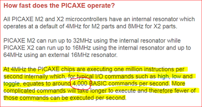

You wrote "...up to 16 million lines of BASIC code per second is a really useful amount of speed!!"
No. Not even close.
16 million (machine) instructions for a 16 MHz device (assuming its instruction set all take a single clock cycle to execute, probably not realistic), not 16 million lines of BASIC code per second. Thousands of lines per second, not millions. In fact this is what they say of their 4 MHz part (from the link you provided):
4000 per second for a 4 MHz part (x 8 for a 32 MHz part and we're still 32000 per second, not millions). Also consider that the high, low, and toggle I/O functions are fairly simple BASIC functions internally and still slow things to a crawl. More complicated functions slow things down even further. The reason? Most of the time isn't spent executing your program, it's spent running the interpreter.

You are being picky, as most code written for PICAXE actually does often have a single command per line, as it make fault finding far easier and the overhead is minimal to none, but as you may not have tried them, you could not be expected to know that.....
Piling more commands in a single line is usually bad programming, at least in PICAXE BASIC anyway. So the "line speed" is high, but you might possibly see that as "cheating".
But even if the speed is only a quarter of what I mentioned (it will usually be higher than that), they are still very fast chips, with the flexibility of BASIC, something many users quickly learn to appreciate.
You might also be mixing up PICAXE BASIC with way older BASICs (PC's GWBASIC for example) worked, as they were interpreted as the program ran, which of course makes things REALLY slow....though some could also be compiled if the need for more speed arose, but then suffered from heavy program overheads, making it still quite slow.
