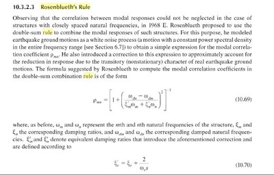

For response spectrum analysis I use the SRSS, CQC and ROSE method to combine the result value (eg acceleration) of the modes. If I have closely spaced eigenfrequencies, I use CQC or ROSE. But what is the difference and when should I use which? Thanks!

Hi. Its about FEM analysis, there are different equations for superposition of modal solutions. It depends on whether the eigenfrequencies are closely together (than they correlate) or not which equation to choose.

I found this:
"Rosenblueth and CQC are similar - they both utilize random vibration theory to represent the seismic loading as white noise, although Rosenblueth assumes finite duration whereas CQC assumes infinite duration. If you plug in some numbers, you can see how the coefficients may compare between the two, although I think that they are generally similar.
The choice tends to be driven by the specification."
on http://www.eureka.im/5132.html
but I don't really know what that means "finite duration" and "infinite duration". Is that with regard to the excitation? If so in regard to earthquakes does the infinite duration make even sense?

The theoretical calculation for the combined effect of two modes assumes an infinite duration of the excitation. This obviously is worst case and overly conservative for design. A correction by Rosenblueth adjusts the result for a short (finite) duration.
It's explained in "Fundamental Concepts of Earthquake Engineering", p203
Re: What is the Difference Between CQC and ROSE Method?
05/19/2017 10:24 PM
Page number in "Fundamental Concepts of Earthquake Engineering" should be 394, paragraph 10.3.2.3 Rosenblueth's Rule.

So what I got is
- CQC and ROSE differ when the ground motion duration is short, similar if long
-ROSE includes a correction for nonstationary effects
- both can be used with or without closely spaced eigenfrequencies, only if damping ratio is close to zero I should use SRSS (I use a damping of 2%, is that close to zero?)
- ROSE gives the best results
So.. does that mean that the computing times goes up with SRSS->CQC->ROSE
but the accuracy goes up also?

Edit: sorry I just read: CQC is bad for damping ratio <2%
