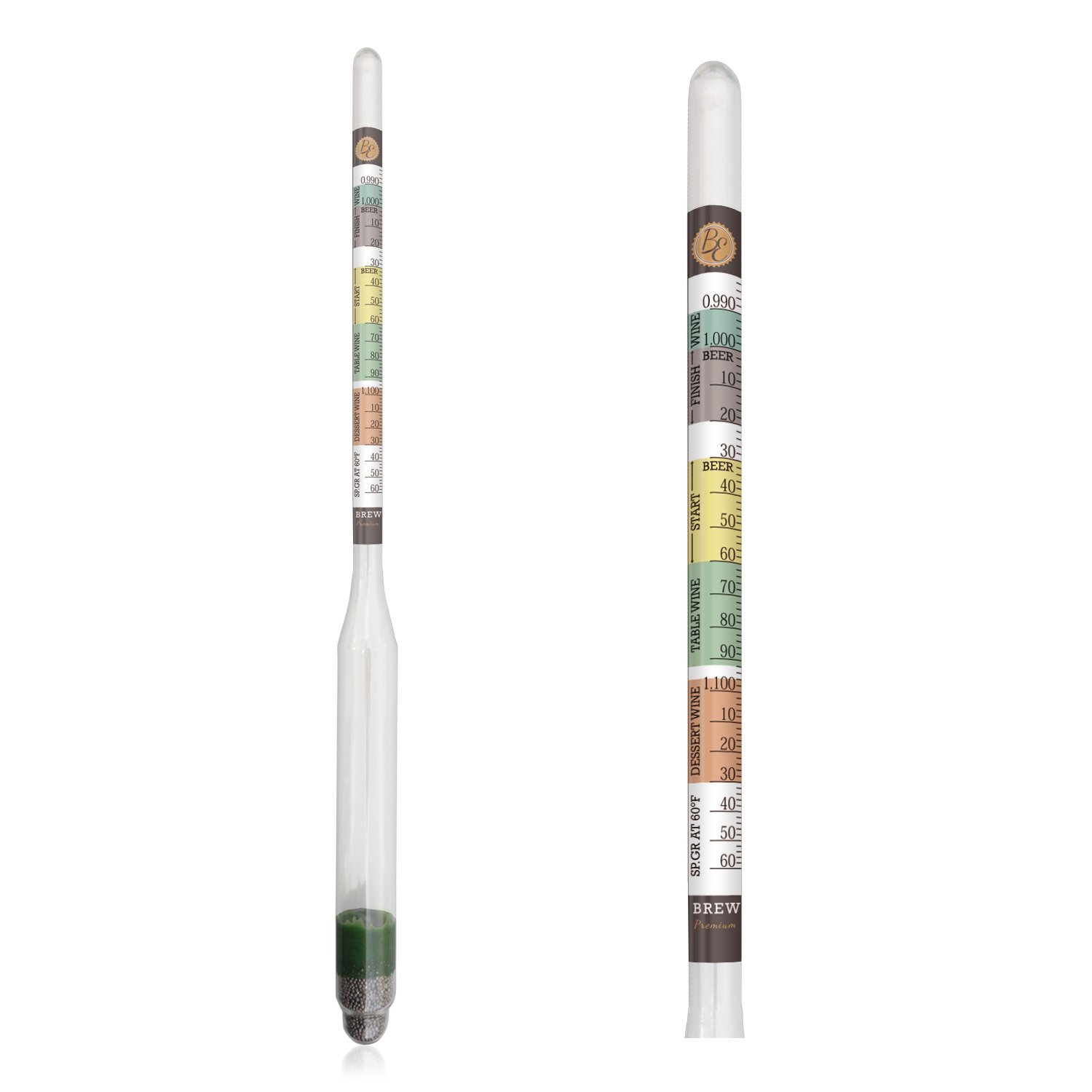

My wife asked me today how she can test the alcohol content of a fermenting food process (such as a Kombucha, or Kefir strain, as it grows/ferments). She needs to be able to test it several times at monthly (or so) intervals.
Taste testing isn't good enough. We are not drinkers, and wouldn't be able to distinguish content by it's effect on us, as a result. Also, because I know some of you will suggest it, lighting it on fire is out. We need to be able to keep the process alive, not burn it to death.

If it's liquid, one way is to measure the specific gravity. Or you can check this link.

Doesn't he need to know the original gravity (the reading before any fermentation), too, along with the final gravity (reading after fermentation) in order to take the difference and make the multiplication (131.25?). He might be too late for this batch? Or is there another way?
Just asking because that's how I know when to rack my beer using a hydrometer.

I made wine for years and I agree with you that you can't just measure the final SG and know how much alcohol there is, you need to know what you started with as well. A little advice on using the hydrometer too, when you drop it into the liquid you should spin it at the same time to stop bubbles sticking to it and giving a false reading.
I use the wine book by C.J.J. Berry which states ABV=(Original SG-Final SG)/7.36. When you have an SG of say 1.075 you would use 1075 in the calculation.

I'd go with the hydrometer. Cheap, easy to use, and works on everything from alcohol to black liquor as far as I know.
