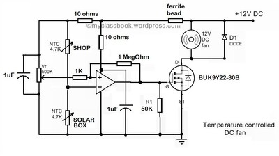

I now want to build a simple and robust DC switching circuit that puts forward bias to the base of a power transistor when a voltage drop is sensed across two identical thermistors.
One thermistor will be in a solar collector air box.
The other identical thermistor will be in my shop.
When the temperature is warmer in the solar collector air box than the air in my shop I want the circuit to forward bias the base of a power transistor. I will use the power transistor to activate a relay which will switch a fan on and off.

I do see one weakness in that circuit: since there is no feedback, there is no hysteresis, so when the two inputs are very close to each other, the output could chatter or oscillate. A very high resistance from the output to the positive input could prevent that.

GA SE. This circuit is a very good start, but it needs a few things to keep it 'happy' in the real world.
First, we should add a little hysteresis to keep the amplifier/comparator from oscillating. What can happen at the time that the comparator changes state, the change in current tends to cause a little voltage droop which can cause the comparator to fall back to its previous state and start all over again. And again, and again. Below is a link to Analog Devices white paper on hysteresis. This is one case where positive feedback in electronics is actually a good thing. The 1Kohm and 1 MegOhm resistors will take care of the hysteresis. You may want to experiment a bit with the value of the 1 MegOhm resistor to see what deadband you get with the switching.
http://www.analog.com/en/analog-dialogue/articles/curing-comparator-instability-with-hysteresis.html
I would also replace the PNP transistor with an N-channel MOSFET, like a BUK9Y22-30B.
https://www.digikey.com/product-detail/en/nexperia-usa-inc/BUK9Y22-30B,115/1727-4615-1-ND/2531005
This MOSFET has a Vgs of +/-15V and handle 30 amps of current with proper heatsinking. That will consume less current because you won't be driving any base current. Make sure the Vgs (gate to source) rating is at least your supply voltage. There are many others from any number of sources that would work just fine as well.
Use twisted wires to connect to your thermistors. Old telephone wire or a pair from a CAT-whatever Ethernet cable is good.
A DC fan on the circuit is going to add a bunch of noise to the bus. Help filter out the noise by adding a ten ohm resistor in the positive connection to the op-amp/comparator and a 1 uF ceramic capacitor across the power terminals of the amp. That will help prevent supply noise from affecting the comparator. Likewise for the reference voltage and the thermistors. A ferrite bead would also be a good idea to add into the positive supply rail between the motor/relay and the 'electronics'.
Add a 50K resistor from the MOSFET gate to ground to make sure that when the comparator goes low, the 50K will help bleed charge off the gate to keep it turned off. This can be an issue when you use a single supply with a comparator.
I did this revision to this sketch entirely with MICROSOFT PAINT!!! http://cr4.globalspec.com/blogentry/28499
Good luck with your quest.

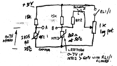

There does not seem to have been a simple answer so far, so this is my attempt, Galivan, I have used transistors and relays....
It uses two identical NTC thermistors in bridge circuit. The type I base design on are interchangeable (0.2 Celsius match) so if they are same resistance, you can be sure they are at same temperature and can be replaced without adjustment. The type below is from www.atcsemitec.co.uk, type SP.
If RL1/1 contact is open and all is at 25'C, NTC1 & NTC2 same resistance, then the bridge is balanced. Voltage A to B is zero.NTC1 is "room" and NTC2 is "hotbox". If NTC2 is hotter than NTC1, then voltage at A will be higher than voltage at B. At 25'C, A-B volts vary about 30 mV for 1 'C difference
However, if RL1 contact is closed, voltage A can exceed B only when NTC2 hotbox is above 50'C with pot at Max (5V), NTC1 staying at 25'C. Pot adjusts difference below 50 'C as required. Resistors can be increased to use a higher DC supply voltage to bridge. Log pot is better than linear because NTC are not linear.
To avoid self heating of thermistors, which are matchhead size, the current thro' NTC must be kept low - values shown give about 0.3 'C max rise. The relay contact must be a telephone type, with twin silver contact points, or a mercury reed relay, for reliable switching of the low voltage or a FET could be switched in place of RL1/1. A second contact of RL1 or another relay with parallel coil could switch fan.
If relay can be de-energised when Volt A greater than Volt B, then it will stay de-energised until the hotbox is cooled to room temp or near (adjusting 15k resistor feeding NTC1 or shunting NTC1 with resistor can adjust NTC1-NTC2 temperature offset to vary "near".

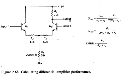

The following circuit for a differential amplifier can sense the bridge imbalance, by connecting input 1 and input 2 to A and B of bridge- I think it is 1 to A to work, if not swap over! Gdif is the gain. Probably easiest way to switch relay is use an FET fed from amplifier output. Q1 and Q2 should be same type of transistor, gain matched for best performance. Circuit diagram from "Art of Electronics" text book by Horowitz and Hill ISBN 0-521-37095-7.
The supply voltages and resistor values of the amplifier can be altered to more convenient values (values in diagram give gain of about 40, A-B difference to output). Ceramic bypass capacitors at Q1, Q2 base are advisable to avoid radio frequency pick-up trouble.
