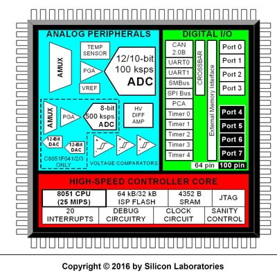

Do you 'know' the carrier frequency of the input signal? Or will that have to be determined from the periodicity?
Is the amplitude of the input frequency constant?
Does the carrier frequency of the input signal vary during operation?
How much resolution does your PWM output need?
For quick processing times, I believe you are stuck with a digital solution as Rixter alluded to above. Analog solutions all have settling time which for low frequencies is a long time.
Edge detection, counter and a divide by function and you can demodulate the input signal, and most microcontrollers have a PWM output. An 8051 micro can do this with ease. I have one of the 'youngsters' in my group do the coding. I used a C8051F040 in one of my designs for a power monitoring and distribution panel. I monitored about a dozen electrical parameters including voltage, frequency, and current as well as temperature and atmospheric pressure (airborne application). There was a lot of 'math' and we had no problem fitting it into the code space.
Check out Silabs.com (Silicon Laboratories).
https://www.silabs.com/products/mcu/8-bit
https://www.silabs.com/documents/public/application-notes/an191.pdf
These little things are amazing.

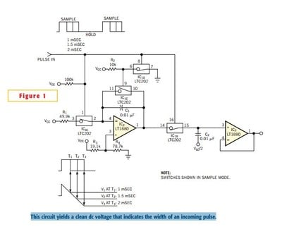

Think of each cycle of you EFI PWM as a sample of the input. By Nyquist, the highest frequency which you can produce is 1/2 the sample rate. So your EFI signal will be less than 5 Hz at 600 RPM and less than 50 Hz at 6000 RPM. I'm sure in reality it will be a lot less than this.
If you filter the PWM signal to convert to a slowly varying EFI voltage signal, at slow speed, you could get some ripple which you do not want to pass on to your 400 Hz PWM output. Another problem is a low pass filter will result in some latency.
Here is a circuit from an Electronic Design News article that converts the PWM to an analog voltage without the ripple or latency. You can then drive your voltage to PWM converter with the output.
http://www.edn.com/design/analog/4347834/Circuit-converts-pulse-width-to-voltage
(There are ICs that do this job, but the frequency specs only go down to 30 Hz. You might want to try one to see what it does at 10 Hz.)
http://cds.linear.com/docs/en/product-selector-card/2PB_2645f.pdf

This looks really good, but I see that it gives a voltage proportional to pulse width, not duty cycle. Not sure that will work for us...gotta noodle on it. Maybe some mod to that circuit would do it. Thanks for the idea!
I have one of those PWM-to-voltage chips that is spec'd down to 50 hz and I'll see what it does at 10hz.
Re: PWM to PWM converter...but no microprocessor
08/16/2017 9:50 PM
You are correct, the EDN circuit needs a constant rate, not variable like yours.
