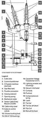

So we have had an AR (Schneider N-series) that's been disconnected from the circuit for a few months now due to nuisance tripping (as reported by the maintenance team). We tried to put it back in the circuit, but on energizing the line our substation line breaker tripped on over-voltage. We've removed the bad boy from the circuit. Could someone render their thoughts on this?
I'm preparing to check for low gas pressure (it has SF6) since this is one of the obvious indications on an over-voltage trip in our case.
Your advise will be highly appreciated.

You are assuming that this particular recloser is causing the problem, yet you have not provided any convincing argument that that is the case.
If your device has an ADVC module then you should look at how it is configured and how it communicates with other reclosers on the line, since a misconfiguration/miscommunication could affect the overall reclosing scheme. You might also check the ADVC to make sure that memory wasn't affected by the long power outage, especially since the hold-up battery is only good for up to 44 hours depending on the options on your device.
The recloser operating mechanism is a stored energy system that uses capacitors to move the contacts inside the VCB bottle, so I would verify that they operate properly. The SF6 gas supply surrounds the operating mechanism, and is there primarily to provide a smaller enclosure with reduced interior clearances between live parts and grounded surfaces.
A loss of gas will reduce the LIWL (Lightning Impulse Withstand Level) by approximately 50%, but should not have any effect on normal operation unless you have very high TOVs (Transient Over Voltages) on the line during lightning/switching operations, hence the request for the SLD.

  1. You are in Uganda. Hence the local Schneider will not help because they have not been paid by your client.
  2. Other "posters" asking for single line diagram is just the standard first step in understanding a strange system. Step 2 on any equipment is checking its power supply is present and correct, which you seem to be following.
  3. Maybe power supply was the original fault, but just disconnecting the power - instead of disabling operation & leaving the battery on-charge has possibly added battery failure to the problems..
  4. Looking at www.schneider-electric.co.uk/, the N-series recloser seems to be a higher current version of "U series" recloser with the same control box ADVC -their document AMTED100055EN.pdf is a brochure with a good description, although the commisioning/fault find manual was not found.
  5. The recloser consists of a pole-mounted breaker assembly with a control box below connected by a cable & plug to socket on pole assembly. It also is usually associated with an isolator switch. You did not mention any of this or write whether the ACR was in the substation or "miles out in the sticks"!.
  6. I guess from your description that an upstream substation breaker trips when the source-side isolator of the recloser is closed?? How long before it trips??
  7. Did the recloser breaker close [or not]?? or open before 6 happened??
  8. I would suggest opening ACR source isolator, unplugging cable to control box, then reconnect MV to ACR - what happens?? Does ACR have event /current/voltage log to recall?
  9. Next try ACR operation with MV isolated - surely the control panel has a test mode?
  10. Finally, reconnect control box, re-apply MV - does ACR indicate/log anything significant??
  11. Has it occurred to you that overvolt trip of substation breaker may be due to load on line connected to ACR, no fault of ACR?
  12. Maybe the absence of helpfull drawings/manuals is due to item 1 above.
  13. Replacement of faulty bits under warranty may be hindered by 1 above!

Ref 8 - Not really clear... this Schneider N series diagram [from document AMTED100051EN.pdf on their website] shows arrestors both sides - which ACR side do you have connected to source? Sorry I was looking at U series diagram but have now found N series. Connection does decide if CVT is source or vacuum switched side.
- The current transformer (#2) would be the source side on our ACR as related to this is screenshot. CVT would be "output" side in our case.
