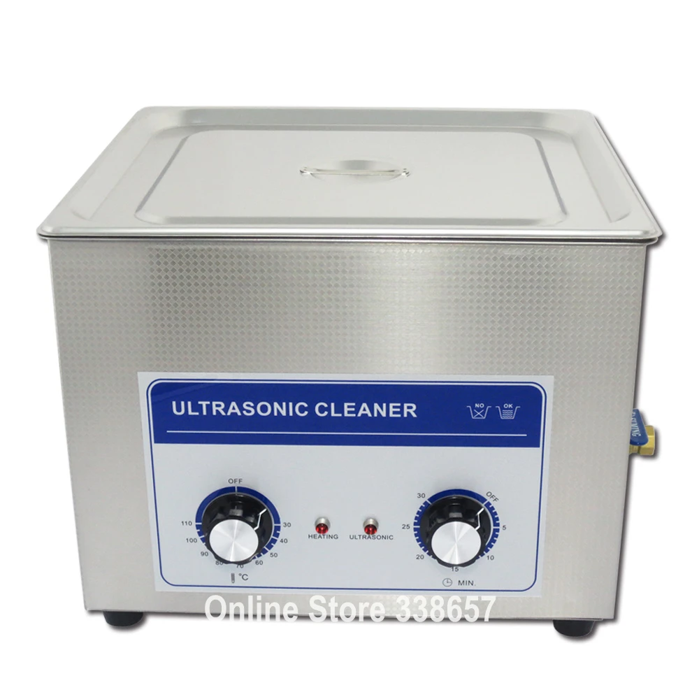

I'd try one of these first:-
Re: How To Remove Sand Blasting Residue
