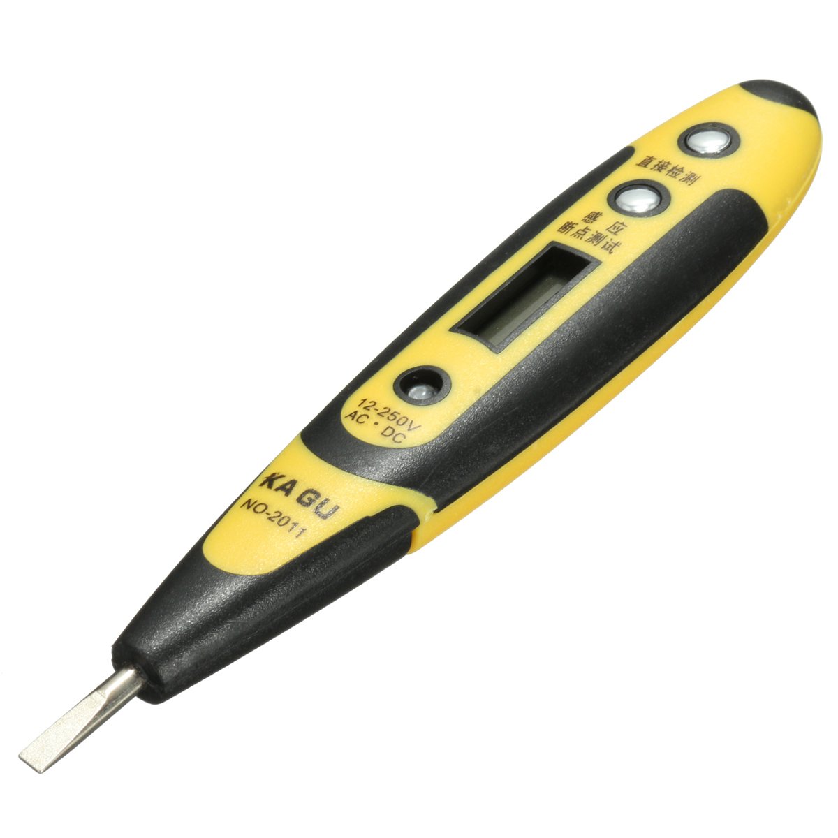

10/04/2017 4:46 PM
Re: Universal Front End for Industrial Controls, Anyone?
10/04/2017 4:55 PM
Isn't that actually called a widget?
10/04/2017 5:00 PM
No it's called a KAGU....
10/05/2017 11:09 AM
Looks like Dr. Who's sonic screwdriver to me.
10/05/2017 11:32 AM
10/05/2017 5:45 PM
Fake!
10/05/2017 2:23 PM
I forgot about those devices. They are really cool but not what I was looking for.
