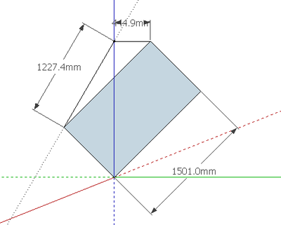

Hello,
I am currently designing a rectangular box enclosure, approx. 1.5m long weighing ~35kg.
The box will be lifted using a crane via a single lifting point on the box. When the box is lifted, it needs to tilt and rest at 45 degrees whilst in the air.
How do I calculate how far I need to place the lifting point/eyebolt in front of the centre of gravity for the box to sit at 45 degrees during lifting?

You make a harness to hold the box at 45° ....A rectangular box supported by one point would not be stable...

If the box is a reasonable height and you determine the height from CoG to the top face, by simple geometry the point is same distance along fom the CoG.
If the height is negligible SE has already given you the answer - it's unstable. But can't somebody put a hand on it hold it at 45deg? For total weight 35kg the force needed is minimal.

Here's the construction (side elevation). Either draw it to scale, or use trigonometry.

10/17/2017 5:36 AM
Perfect, finally got my head around it thanks!

This presumes the box is of uniform density.
Re: Single Point Lift @ 45 degrees
10/17/2017 10:50 AM
Quite. But as long as the position of the C of G can be established (and is fixed) the same method applies.

Lifting point would only be corner for 45deg for e.g. a square side elevation with central C of G.
Also box C of G must be fixed and locateable.
