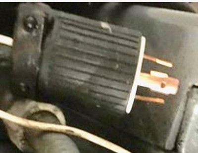

Hi everybody,
I recently squired a new to me 1954 Wells-Index 55 vertical milling machine.
while I love staring at this beautiful piece of equipment I need to get power to it and start machining some stuff.
I have a question about grounding it.
It is wired up for 240 single phase but the pigtail coming off the machine has what appears to be a grounding wire...but it was not attached to a bolt on the machine and after tugging the wire a bit it came out of the pigtail. should I connect it properly and bolt it to the machine?
I also took the cap off the wiring box on the motor and the green ground screw had nothing attached to it.
See pics for more info. Any guidance would be greatly appreciated.

Ground it!
Two reasons:
1. 220 V can hurt you.
2. If an accident should happen, your insurance company may refuse coverage if the machine is not in conformance with local codes.

Yes the green wire should be grounded on the machine and the motor and the box receptacle on the wall and the conduit and continuing to a ground rod outside...anything that is metal and can be touched should be grounded...green or bare wire, stranded or solid...

I assume that "east coast" refers to the United states. I also assume that this mill is to be installed at your home, since most industrial buildings have 3-phase wiring.
A common color code for 120/240 Volt "split phase" residential and small business wiring in the US is white for neutral and black for either phase of 120 V. 240 V wiring commonly has black for one phase and red for the other phase, again with white for neutral. That white neutral wire is likely connected to ground inside your breaker box, but for safety, a separate green or bare wire is usually used to insure grounding of the housing of any device having a metal exterior or other exposed metal parts.
I can't quite tell from the photos whether that plug has three or four terminals. If it has only three terminals (as I suspect), then you have no choice: the long terminal with the extra bend (and probably with a green coated screw inside) is neutral/ground, and it should be connected to the green screw inside the motor connection box with either a white or green wire.
Finally, I'm assuming that you have an existing, correctly wired, 240V outlet for it to plug in to. If not, then your best bet would be to rewire the motor for 120V operation, as specified on the motor nameplate. The motor should still be grounded. Note that the motor is rated at 21.4 Amps at 120V, so it needs to be connected to an outlet supplied by a 20 AMP breaker. Although 21.4 Amps should trip a 20 Amp breaker if left at that current for very long, the actual current used by the motor depends on the load, and with home use, you will likely never get even close to that current limit.
Note that this is NOT legal advice! It is advice from one who has done what you want to do.
Re: Milling Machine Wiring Issues
02/07/2018 1:44 AM
It appears that you have a, " Twist lock plug ".
The blade that has the 90* angle is the ground.
Inside the plug will be 3 wire attachment screws, the ground goes to the aforementioned blade.
The white wire goes to the silver screw.
The black wire goes to the black or dark colored screw.
I would recommend using a new 12 ga. Jacketed 3 conductor cable.
And a new twist lock plug.
02/07/2018 10:59 AM
That would be correct IF he had a ground (bare or green), a white, and a black wire. In his photo, I see two blacks and a white.
To JJSeeker: The twist-lock plug shown in your photo appears to be of the kind normally used for 220V, but I can't read the text on the plug, and there does exist a twist-lock for 120V. I assume that you know from the previous owner that it is wired for 240V, but before you connect power, check to be sure that there is a single group of three connections joined together in the motor's connection box, as shown on the motor nameplate:
Also note that NONE of the motor wires connect to ground or neutral; only the motor case connects to ground/neutral.
Also, do measure the voltage at the outlet to be sure it is correct before inserting the plug. Don't worry about the motor nameplate indicating 230V, while you have ≈240V at the socket. It is actually better for the motor to have a voltage slightly higher than the specified voltage, than to have a voltage slightly lower.

I agree. He has a 4 wire twistlock with only 3 wires. He could add a ground and connect that to the machine body/case. He could also tie the neutral to the body as well. If the machine is a pump, then the tie would be the wrong way to do it and he would need GFCI breakers and a separate neutral and ground. However, he is running a milling machine with a single phase motor so the neutral/ground tie would give him a good clean connection and a robust current capacity on his wiring that would benefit a breaker trip should something go wrong with the motor.
02/07/2018 3:50 PM
After enhancing and enlarging his photo, I agree that it appears to be a 4 wire plug:
Now clearly the ground connection must go to the long terminal with the 90° bend. How the other three terminals should be connected depends on how the socket is wired. If the wiring of the plug does not agree with that of the socket, there will almost certainly a blown circuit breaker, and/or major fireworks.

02/07/2018 4:35 PM
Thanks everyone for the comments.
It is indeed a four prong plug, with only 3 wires attached. I will be wiring the outlet (4 prong)to match the plug. The white wire will be attached to the ground pin on the plug pictured and attached to the body of the machine.
The circuit will be wired 240v single phase and I’ll use a 30amp double pole breaker. With all wiring sized accordingly.
Ill use 3 wire conductor to run from the outlet to the panel with ground and a conductor from each pole.
thanks again to those offering helpful guidance
jj

If you are going to use a three conductor cable, then tie the neutral and ground pins together. Don't leave a floating leg.

Maybe I was wrong. I saw two black wires coming out of the motor junction box, I was thinking that L1 & L2 was attached to each black respectively. The white with the curl was attached to a screw as a ground, where white should of been common, and a separate green should be ground. Later after thinking about it, I thought the original installation was where neutral and ground are common from the breaker box, with metal emt carrying ground, rather than a separate ground to earth. I thought that if the winding shorted, and you touched it, you could get shocked since at that time, shoe soles were leather and current could follow to a concrete floor.
02/07/2018 9:12 PM
"I saw two black wires coming out of the motor junction box, I was thinking that L1 & L2 was attached to each black respectively."
That's what I saw, and think, too, at the junction box and pigtail.
But, seeing that short pigtail, my bet is that at the previous location (not necessarily the original), it was powered by a flexible cable (like or actually an extension cord), probably one with three conductors.

"You need to account for the fourth leg in the plug because you don't know which of the two unconnected terminals are going to be connected through the four wire plug. "
He'd better know that before connecting. Over the years, I have seen several outlets that were not wired correctly. It is always wise to check before wiring or plugging in the device. Anyone who does not at least have a voltmeter, shouldn't be doing any wiring!
In case it wasn't known, this graphic from Wikimedia may be useful:
The correct plug should be the L14-20 or L14-30. In his photo, I think I see the tab on the ground lug extending outwards, indicating an L14-20.

I strongly disagree with your continued recommendation to tie the neutral and ground together in the male cord end! This is a 240V system with no neutral on the machine. The NEC clearly specifies that the only place where the neutral and ground are to be connected together is at the service entrance panel. It used to allow (and one can grandfather in) an exception for the frames of clothes dryers and ranges, but that has been deleted for a number of years. Tying the two together creates the very real possibility of an unwanted current on the ground conductor, which is defined as a non-current carrying conductor present only to carry fault current when there is a short to ground and allow the fault current to trip the overcurrent protective device (typically fuse or circuit breaker).
JJ should use a 3-wire flexible cord with the proper end on it and plug it into a properly sized and selected receptacle outlet. This in turn should be on a breaker selected to allow the motor to start and get up to speed. For a circuit breaker the size is not over 250% of the motor's full-load current, but can be increased to the next larger size if it is in between the two sizes. The suggested 30A breaker, with 12-gauge wire meets these code requirements for the motor at 230V (high voltage). The receptacle can be the NEMA L6-20 type or the NEMA L14-20 type (with the neutral not used on the cord).
Thanks--JMM, master electrician since 1979.
