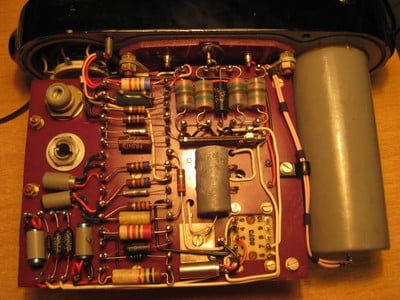

Here are a couple of photos of the inside of an old military UK geiger counter that I own! Still works! There are no references to it on the internet at all , and I was thinking it was made in the 70s . I find its construction interesting and would welcome any comments as regards guesses as to age or anything else. Thankyou.

I would look for some 'date of manufacture' info on the components...or a date code in the serial number....
This is from the early 50's...
https://en.wikipedia.org/wiki/Civil_defense_Geiger_counters

Thanks for reply. Years ago I used to own the one you pictured. I looked on the inside of this current one and dont see a date. One number says 8073 which might be 8th week of 1973 but not sure.

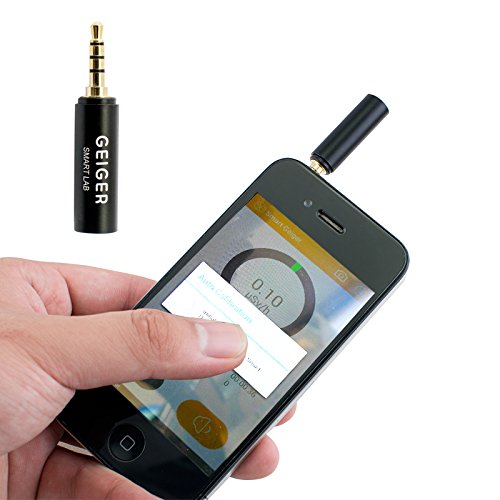

I bought the one shown below a while back from Amazon. It plugs into the earphone jack and is only sensitive from the direction it is pointed.
It does react to a piece of uranium ore that I purchased from United Nuclear.
http://unitednuclear.com/

Yes that ion chamber one of yours is for after the bomb has gone off so its insensitive. Mine has a GM tube in it and will register if you show it anything more than 10 microsievert/hour. I had one of those phone ones and they are great but only go up to something like 100 microsievert/hour. Thanks for your reply.

I would suggest that the build time frame would be early 1950's. The molding technique of the capacitor would match what I find inside some similar vintage National Radio receivers that I have rebuilt. If it was constructed in the 1970's the capacitors would be epoxy dipped. A good resource I find is either old Farnell Electronics catalogs, or on this side of the pond, Allied Electronics catalogs.

My guess would be that it pre-dates 1968 when FR4 board material was introduced. Your board seems to be Bakelite or G10 or some similar material.
I see no evidence of printed circuit on either side, and the through holes do not seem to be plated through.
This "high value" item would have used leading edge technology (if it was for military use) and thus possibly pre-dates 1950 when single sided boards became available.
I suspect however that it post-dates 1945 as all the insulating material seems resin based as opposed to wood and other insulation used in the '30's.
Production dates on capacitors might provide "most recent" repair, or indicate year of manufacture. If there is a moving coil meter, then sometimes the technician would pencil the date onto the non-visible portion for traceability purposes.
