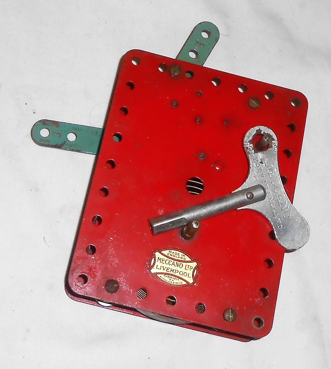

Re: Push - Retract - Hold without Linear Actuator - HELP
02/27/2018 1:26 PM
You could make a larger version of this wind-up reversing motor...and a simple braking apparatus....you can purchase spring steel and make your own...
http://www.ebay.co.uk/bhp/clockwork-motor

I just did some research on the item but I don't think it is what I need. We want to connect the device we use for the motion to the internet so it can connect to an app on your phone. I know it doesn't fit here but I wanted to explain the whole situation. I need to know if any solenoid(or other device except from Actuators/Electric motors) exists that can do the Forward/Backward and hold(in the middle or somewhere else between the IN/OUT parameters) motion on command so we can connect that to a chip and connect that chip to the Internet.
02/27/2018 3:34 PM
You can use a solenoid to wind the mechanism and electronic components to control everything....everytime the spring winds down it hits a contact that triggers the solenoid, it's automatic winding...this strategy was used in early automobile clocks...
