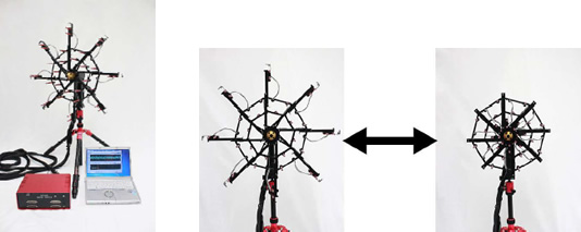

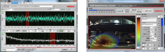

Re: Vibration Analysis and Location
05/19/2018 4:23 PM
Hey, you're making it harder and harder...
I've often dreamed of having a device that could localize sound and display the position on a video picture.
Here is something I found that may be of some help. I have no idea what it costs...
https://www.nissan-global.com/EN/LICENSE/PDF/technology10.pdf
https://www.nissan-global.com/EN/LICENSE/TECHNOLOGY/TECHNOLOGY10/
