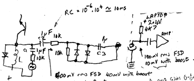

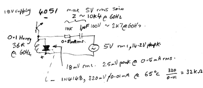

You did not write if the solenoids are DC or AC. I suppose DC, because you mention a current drive. What voltage? - affects voltage rating of multiplexers.
Obviously, 4051s could be usefull - but if all solenoids are not on together, you may need only a small number of shunt resistors on supply feed side, it might be possible to detect faults like one solenoid driver always on.
A current drive will not have infinite voltage, so there will be an exponential rise.
My main worry would be that mechanical delays/times of movement may be far longer than any R-L delays, so you will not see any effect on current curve. DC solenoids I have dealt with can have very long release times (seconds) due to diode & shorted-turn effect of aluminium casings.
You need to do some tests to determine current & mechanical movement time constants before worrying about in-production measurement circuitry.
If the coil is not saturated, or is de-energised while returning by spring, applying an AC sine voltage & measuring AC current may reveal inductance, in effect the magnetic gap/plunger travel. This appears capable of detecting incomplete or slow return.

The application of a very low level AC signal to detect the health of the solenoid is a very good idea,and I will explore this possibility.
It could possibly be capacitively coupled to the solenoid to provide real time information.

Maybe this:
A small transformer at the controller end in series with the solenoid. Characterize the signal in normal operation, then hold the plunger out and see how the signal is different. It may be as simple as detecting a level change. Feed the good/bad conditions to some muxer to alert an operator, etc. If you want to get info re a weak spring, you might need some software to detect waveform change.

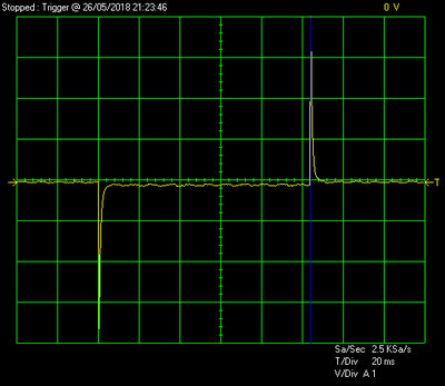

Don't hypothesize on hypotheticals.
Hook your CRO up, get good waveforms, and bad waveforms. You may have to simulate a sticking solenoid to get the bad?
The answer, then, may be staring you in the face.

My intention from the start was to do just that,but the problem is how to detect and differentiate the good/bad in an economical way.
The simplest device I could think of is a very low value resistor in series with the reverse-biased diode,and use the voltage drop across the resistor to generate the signal.
