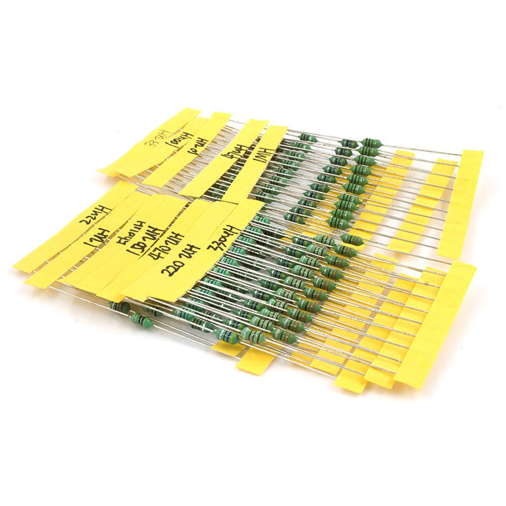

I've had a failure on one of my garden lights...at first I couldn't find the problem, but on closer inspection it looks like the resistor has failed...
...am I correct that this is a 200 ohm resistor?....any thought on what has caused the failure, and if I replace it, what are the chances it works? The battery is charged, and the light works, I don't see any other problems....

To me the left band looks more blue than silver, in which case it could be 62 Ohm, 1% ..... put a multimeter on it if you can get a contact at each end to be sure.
Re: Solar powered garden light
05/31/2018 12:50 AM
I think we've ALL been barking up the wrong tree!
I was bothered by that apparent 1kΩ resistor, which is way too high for most applications operating off a single cell, So I took apart one of my garden lamps (it needed cleaning anyway).
This is clearly a different unit, but it has a very similar device, with the colors Green, Brown, Black, Gold(not obvious in the photo), BUT it is labelled L1, and its measured DC resistance is 0.8Ω.
It's an inductor!

Good call, I had totally missed that. The body colour should have given it away as, although I rarely use them, all of the axial inductors that I have are that same colour.
That one of yours would be 51µH 5%, SEs would be 1000µH 10% - big difference for similar applications.
There is normally a larger space between the multiplier and the tolerance bands and, while it's hard to tell definitively, there looks to be a greater space between the 2 at the RHS so maybe SEs colours are grey,red,black and gold giving 82µH.
05/31/2018 10:00 AM
OK got some more pictures....
There are 3 components....
I think you're right, the smaller one seems to be the resistor(brown, green, orange and gold), the green thing is labelled V1.C, you can see the connection here in detail with the white stuff, looks like flux....
The yellow and black wires on the top are from the solar collector, and the red and black wires on the bottom are to the LED...
"Therefore value = 27 x10 = 270µH +/-20%" in this example...

And yours is 1000µH or 1mH
How big is it?
05/31/2018 2:57 PM
I'd say about .25"...
Brown, Red, Black, silver.... = 12 microhenrys
05/31/2018 3:34 PM
Then this Bourns one is the closest I can find at Digikey
Brown black red silver: same as yours
1 milli Henry (though they have incorrectly said Mega Henry)

I found this about $.09 each...
05/31/2018 8:57 PM
....er 1 mH...but I don't know the watt rating .25 or .5 .....?
06/01/2018 11:15 AM
¼Watt will be plenty.
Good luck trying to get anything delivered from India. At least we now know what they really should cost.
06/01/2018 12:30 PM
I found them for $.06 ea,,, but the catch is you need to buy them in an assortment of 120 pieces....still only $8.00,,, but on the plus side I'll have 10 of them and a bunch of other sizes....

Even though I now know (almost certainly) that the device in question is an inductor rather than a resistor, I still stick by my contention that the device shows no signs of failure. It is only the connection that appears to be defective. Have you tried re-soldering the joint?
Likewise, have you attempted to measure the DC resistance of the device? An inductor this size should measure a few Ohms (including a couple of Ohms of lead and contact resistance), or less. Mine indicated 0.9Ω on the meter (Fluke 116), while direct contact of the meter leads indicated 0.1Ω, leading to the value of 0.8Ω. The only likely mode of failure for the inductor would be to lose contact (break), presumably resulting in a measured resistance of millions of Ohms to Off-scale.
Why buy a replacement for a perfectly good device? You do have a multimeter and soldering equipment, don't you?

Yes I'm going to check it first....will update...
I got ~13 ohms...?

That 13Ω measurement pretty much assures that the inductor does not need replacement; only re-soldering.
Something just occurred to me this morning: most inductors have a magnetic core, while the cores of most resistors are made of non-magnetic materials. Many resistors do have magnetic end caps (as I found out this morning), but with a very small rare-earth magnet, it is quite possible to tell that the magnet is only attracted to the ends of the 1/4 Watt resistors, and not to the core, while the magnet IS attracted to the core of the inductor. Another way to verify that it is indeed an inductor, not a resistor...
