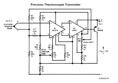

This is a thermocouple transmitter from the National Semiconductor data sheet for the LM10 [obsolete] - I send it because I knew it had T/C amp.
There are many operational amps to choose - TLC271 is more modern, single end output -some changes to connections. Cold junction temp compensation will need adjustment according to thermocouple type as will gain according to T/C required temp range and output volts to drive Analog-digital/display.
The LM10 provides a precision supply. Beware of using supply straight from LM117/LM317 and related stabilisers used for op-amp supplies - long term drift is very poor (read the data sheet!).
www.tc.co.uk has good data on thermocouples.

A more simple T/C amp from same source.
Connect pin 7 direct to positive supply, not pin 6 output as shown -then a standard op-amp like TLC271 can be used, with pins 1 & 5 unconnected. TLC271 pin 8 can be used to set its current consumption/gain-bandwidth, connecting pin 8 to + supply (as pin 7) will probably suit your application with high gain & low bandwidth - but low output current capacity from pin 6.
Pin 1 gives a precision 2V supply from the 200 mV reference in the LM10 [R5 & R6 give a 10:1 ratio]. You can replace this with a suitable 2.000 V reference or alter resistor values for 2.500 V/5V/10V reference, which are "standard catalog options".

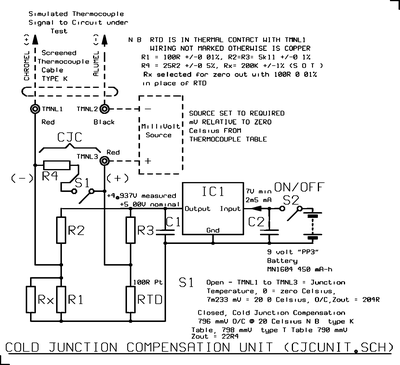

I suppose you connected a DC source between Vin+ and Vin- with Vin- grounded.
It seems elementary, pardon me! but a T/C will not give a voltage if it is on bench at same temperature as amplifier. Warming T/C in your hand will give about 800 microvolt.
"Simulation" can mean a totally mathematical model on a computer, but I assume you mean a real "hook-up"!!!
You should post a readable circuit of what you are doing and identify supplies & test voltage sources used. Hand sketches can be scanned and posted - I find conversion from .bmp as scanned to black & white type .png files cuts file size drastically.
This may be a case where real equipment does not put its features onto the circuit diagram for you.
DC source may be grounded by connection to a metal case, which is wired to power socket earth. But supply to ICL7107 etc may come from lab power supply which is "floating", insulated, it may carry AC mains voltage due to capacitance coupling.
Lab p.s.u. will certainly have transformer isolation, but transfos usually have mains winding & LV winding one over the other with high C coupling. But if mains neutral (commonly earthed) is connected to "near" end of HV winding there is just a few volts to earth instead of 240V. Many countries have reversible mains plugs so interference can stop/start due to how plug is inserted.
When dealing with very small voltages, using battery powered sources, AC and DC, avoids a lot of such problems. It is also necessary to use screened cables and metal enclosures to keep out unwanted pickup with long runs from thermocouples - even from yourself. When you get the chance, touch the signal input probe of a high Z oscilloscope with a finger - you will usually get 10s of volts AC from mains pickup.
Sometimes, mains pick up can swamp the wanted signal - even rectify on the hidden diodes in integrated circuits (e.g. input to common) and produce a DC error.
Inputs + and minus usually have limits (common mode) on their mean voltage as well as the + to - difference; see data sheet. A typical case is op amps designed to use + and - power supplies where connection of input to either supply cause malfunction - even fatal damage.
Finally,some circuits I have made and used for T/C simulation...
The first is a variable battery source, which can feed a resistive divider to get millivolts. There are plenty of 1.22V precision regulators similar to ZNRE125.
Second is a cold junction simulator, very necessary with a millivolt source to simulate a thermocouple or to make measurement with thermocouples - all tables give e.m.f. relative to 0 Celsius cold junction. This is good enough in room near ambient temperature 20'C.
For accurate result you need close tolerance resistors (+/- 0.01%) and accurate voltmeters and much care (e.g. soldering the 0.01% resistors can cause 0.01% change, so get wire-end types you can clamp in bridge terminals or solder with copper heat shunt pliars and long leads).
You ask what amplifier IC to use. It depends on T/C type and how accurate you want to be. If you look-up the accuracy of cheap T/C type K (also called chromel-alumel or NiCr-NiAl - positive material always first) you will find it is about +/- 3 Celsius at ambient (assuming your cold junction is good) worse at 100'C.
It is not worth making a precision indicator with such a T/C so a " type K" amp with temperature drift of 20 microvolt for use in 20 +/- 5 'C room - about 0.5'C error - is OK. Lots of better multimeters can read T/C.
If you have a platinum T/C, this is expensive but accurate and stable over time. But it has a smaller voltage, 1/4 type K. Usually they are sub-standards to check/calibrate other T/C. So any amp used with it must be very accurate & stable too - or accuracy of platinum is "thrown away".
Of coarse, that means more costly - the amp in the precision platinum T/C transmitter I gave circuit for - LM121A costs $30 or so compared to <1$ for many available (but it is in a hermetic seal metal can to ensure stability - not cheap plastic). It has very low offset voltage and drift - so accurate that its offset voltage is a linear function of temperature and can be used, in that circuit, as cold-junction compensation! For accuracy, everything else in the installation has to be much better too - this may include the material of terminals and extension leads matching the thermocouple.
If you look for LM221 data sheet (lower temperature range version), this is easier to find.
