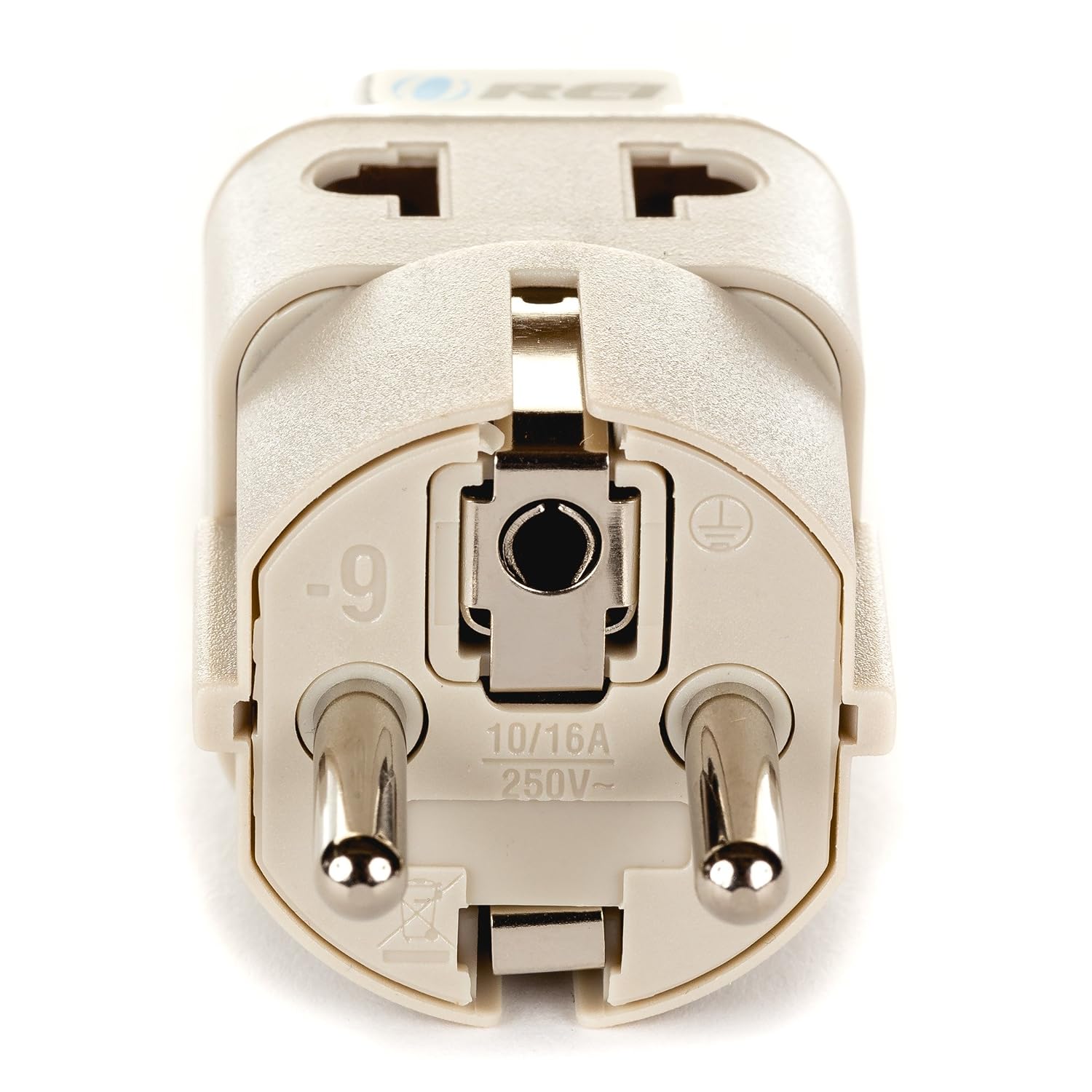

Previous in Forum: Time to Edit a Post...   Next in Forum: The 6 Moon Landings
44 comments
Join Date: Aug 2018
Posts: 16
Earthing Solution For Renters
08/09/2018 3:28 AM
Greetings all,
I'm new here so please bear with my inexperience.
As the title of this thread suggests I would like to know if there are any earthing solutions for renters. I have been renting for a long time and where ever I go, there is an absence of a good permanent earthing solution. Being a renter I would not invest in permanent earthing solution every time I go to a new place. Is there a way to solve this problem as it is becoming a pain a deal with.
Re: Earthing Solution For Renters
08/09/2018 6:39 AM
You might consider to move.
Oh well that's how you noticed....!
Where in this world are you?
There should be electrical codes where you are or not, the electrical system already should satisfy these codes?
Maybe there is real housing available that has proper installations.
The last thing you want to do is to install electrical safety devices yourself.
What did you use until now? Earthing rods?
Join Date: Aug 2018
Posts: 16
Re: Earthing Solution For Renters
08/10/2018 2:05 PM
The problem is the locality where I live. Most of the houses built here are not properly grounded i.e. electrical earthing system and by which I mean the process of transferring the immediate discharge of the electrical energy directly to the earth by the help of the low resistance wire. HOPE that this makes it clear that I'm not talking about some "spirituality and bonding with Mother Earth" like some of the other users here are assuming. NOT HELPFUL, perhaps I should have given more clarity to my question.
Look, whenever I'm using my computer I get shocked. I consulted the landlord and confirmed that there is no proper grounding for the building and they won't do anything about it. I'm not an electrician and not licensed to do anything related to it so I thought there might be a solution to my problem. Also, I can't make any permanent modifications to the property.
Re: Earthing Solution For Renters
08/09/2018 7:45 AM
You need to find some common ground with your landlord.
...For the love of Cliff? Will you tell us WHY you need a permanent earthing solution in your temporary housing?
Posts: 7458
Re: Earthing Solution For Renters
08/09/2018 12:03 PM
Similarly, for the love of Cliff, what makes you believe everywhere you rent from lacks "...a good permanent earthing solution.", and why is this such an urgent problem?
Waiting for the spammer solution to the stated problem.
Re: Earthing Solution For Renters
08/09/2018 1:13 PM
Avoid liability....Contact the landlord, get a licensed electrical contractor to check your ground...But first, what are your claims based on, in other words what tests have you performed....? If the contractor and landlord disagree with you, and claim the ground is acceptable.....then your hands are tied....you can't make changes to the property without the landlords approval...If you are a licensed electrical contractor and can get corroborating statements from other contractors, and the situation is deemed unsafe, you can force action....
Join Date: Aug 2018
Posts: 16
Re: Earthing Solution For Renters
08/10/2018 1:44 PM
OK. The problem is the locality where I live. Most of the houses built here are not properly grounded i.e. electrical earthing system and by which I mean the process of transferring the immediate discharge of the electrical energy directly to the earth by the help of the low resistance wire. HOPE that this makes it clear that I'm not talking about some "spirituality and bonding with Mother Earth" like some of the other users here are assuming. NOT HELPFUL, perhaps I should have given more clarity to my question.
Look, whenever I'm using my computer I get shocked. I consulted the landlord and confirmed that there is no proper grounding for the building and they won't do anything about it. I'm not an electrician and not licensed to do anything related to it so I thought there might be a solution to my problem.
Re: Earthing Solution For Renters
08/09/2018 1:20 PM
I notice this is under "General Discussions" instead of "Electrical Engineering". Please don't go into a misunderstood and misappropriated sales pitch about spirituality and bonding with Mother Earth. I remember the 60's.
If your landlord is preventing you from practicing your spiritual beliefs then they're wrong. Depending on your local government, your landlord may be legally justified or you may have legal recourse against your landlord. Regardless, you are not allowed to permanently modify anything of this rental property without the owner's permission.
Re: Earthing Solution For Renters
08/09/2018 2:50 PM
90% earthed...
Re: Earthing Solution For Renters
08/10/2018 1:14 AM
It might get better than that in a few hours if he's drinking salt water.
..that guy will do anything for a good ground..
Maybe he needs a rock solid faraday cage to protect his brainwaves from power lines?
Join Date: Aug 2018
Posts: 16
Re: Earthing Solution For Renters
08/10/2018 1:55 PM
WOW! This really works????? Hope you know I'm being sarcastic here.
Read my comment at the end (comment by the OP) for more clarity. If that still doesn't help, kindly ask.
Location: Iqaluit, NU. Canada
Posts: 1854
Good Answers: 140
Re: Earthing Solution For Renters
08/09/2018 4:57 PM
You are all missing the point of his question, he is clearly looking for a solution on how he may fill one room of his rental unit with earth so he can grow things.
Join Date: Aug 2018
Posts: 16
Re: Earthing Solution For Renters
08/10/2018 2:01 PM
Am I? Do you read minds through the internet?
Read my comment at the end (comment by the OP) for more clarity. If that still doesn't help, kindly ask.
Re: Earthing Solution For Renters
08/10/2018 2:32 PM
We cannot read minds either. You still have not identified where you rent. Your landlord may be renting a building that does not meet local electrical codes. Then again your computer power supply may not comply with local electrical codes, too.
Go help yourself.
Location: Iqaluit, NU. Canada
Posts: 1854
Good Answers: 140
Re: Earthing Solution For Renters
08/10/2018 8:44 PM
As you did not get it, that is what is known as "humour".
Join Date: Aug 2018
Posts: 16
Re: Earthing Solution For Renters
08/11/2018 8:17 AM
Look, I'm beyond frustrated with these landlords so humour doesn't really help here. But yea I later realized it was funny.
Re: Earthing Solution For Renters
08/09/2018 9:25 PM
Normally adding an earth to a site which doesn't use the earth as part of the electrical protection scheme is not advised and can be dangerous, but there are exceptions. This is assuming the site is electrically compliant with the local electrical codes and regulations (are you saying the places you stay are not?).
What country is this in and what is the special equipment that requires earthing or grounding?
Are you actually talking about lightning protection of a ham radio tower or similar?
More information is required to help answer this question.
Join Date: Aug 2018
Posts: 16
Re: Earthing Solution For Renters
08/10/2018 2:07 PM
The problem is the locality where I live. Most of the houses built here are not properly grounded i.e. electrical earthing system and by which I mean the process of transferring the immediate discharge of the electrical energy directly to the earth by the help of the low resistance wire. HOPE that this makes it clear that I'm not talking about some "spirituality and bonding with Mother Earth" like some of the other users here are assuming. NOT HELPFUL, perhaps I should have given more clarity to my question.
Look, whenever I'm using my computer I get shocked. I consulted the landlord and confirmed that there is no proper grounding for the building and they won't do anything about it. I'm not an electrician and not licensed to do anything related to it so I thought there might be a solution to my problem. Also, I can't make any permanent modifications to the property.
Good Answers: 92
Re: Earthing Solution For Renters
08/09/2018 11:21 PM
We highly recommend hydroponics. They are much more portable than permanent earth solutions...especially when the authorities are looking!
Join Date: Aug 2018
Posts: 16
Re: Earthing Solution For Renters
08/10/2018 1:51 PM
Look at that, ain't you "smart".
Read my comment at the end (comment by the OP) for more clarity. If that still doesn't help, kindly ask.
Join Date: Feb 2017
Posts: 44
Re: Earthing Solution For Renters
08/10/2018 12:06 AM
The OP's question is concerning the following links:
https://www.drweil.com/health-wellness/balanced-living/healthy-living/is-there-anything-to-earthing/
https://draxe.com/earthing/
https://heartmdinstitute.com/alternative-medicine/what-is-earthing-or-grounding/
https://articles.mercola.com/sites/articles/archive/2015/11/21/grounding-effects.aspx
As for earthing solutions in an apartment, I suggest doing an Internet search to see if you can find a viable solution.
Re: Earthing Solution For Renters
08/10/2018 12:19 AM
With one post and so little info supplied how can you be sure?
Titaniumshield does sound a bit like a fancy version of "TinfoilHat" as a user name, but it is not really evidence. Is this a repeat user using a different user name?
Location: USA
Posts: 113
Re: Earthing Solution For Renters
08/10/2018 8:00 AM
Geez, he's giving titanium a bad name
-TiQE
Join Date: Aug 2018
Posts: 16
Re: Earthing Solution For Renters
08/10/2018 1:59 PM
Really Titaniumshield sounds a fancy version of "TinfoilHat".
No, this is not a repeat user nor a fancy tinfoilhat.
Read my comment at the end (comment by the OP) for more clarity. If that still doesn't help, kindly ask.
Join Date: Feb 2017
Posts: 44
Re: Earthing Solution For Renters
08/10/2018 2:23 PM
After the Op clarified his question, I found that it wasn't about "earthing" like I thought, after all.
Join Date: Jun 2010
Posts: 343
Good Answers: 32
Re: Earthing Solution For Renters
08/10/2018 3:45 AM
A lot more needs to be UnEarthed before a Good Earthing can be established.
Join Date: Jan 2015
Posts: 178
Re: Earthing Solution For Renters
08/10/2018 12:47 PM
You may be able to get some large storage containers and fill them with soil. Plant something like Kentucky 31 fescue. It is hardy and will withstand many things.
Place the containers where sunlight can reach them. In a few weeks you should have a good stand of grass. You can then stand in the containers on your 'lawn' and begin earthing.
If you are also a Breathairian, The air filtered through the grasses may help provide needed nutrients.
or ask someone who actually follows these things.
Join Date: Aug 2018
Posts: 16
Re: Earthing Solution For Renters
08/10/2018 1:48 PM
OK. The problem is the locality where I live. Most of the houses built here are not properly grounded i.e. electrical earthing system and by which I mean the process of transferring the immediate discharge of the electrical energy directly to the earth by the help of the low resistance wire. HOPE that this makes it clear that I'm not talking about some "spirituality and bonding with Mother Earth" like some of the other users here are assuming. NOT HELPFUL, perhaps I should have given more clarity to my question.
Look, whenever I'm using my computer I get shocked. I consulted the landlord and confirmed that there is no proper grounding for the building and they won't do anything about it. I'm not an electrician and not licensed to do anything related to it so I thought there might be a solution to my problem. Also, I can't make any permanent modifications to the property.
Join Date: Jan 2015
Posts: 178
Re: Earthing Solution For Renters
08/10/2018 2:43 PM
Are the receptacles properly wired with a ground or is it missing?
I replaced all receptacles and light switches before I moved in to our new house. Wife didn't like the original ones. I'm glad I did. I was surprised how many had loosened over the life of the (only) 30 year old home. Some actually sparked from the wire to the terminal screw as I pulled them from the wall.
Is the plumbing metal pipe? (shouldn't do this but it was done at one time)
Offer to pay some (help) to have a ground rod(s) installed? Money is probably an issue.
Obviously I'm NOT an electrician.
Join Date: Aug 2018
Posts: 16
Re: Earthing Solution For Renters
08/10/2018 2:49 PM
Are the receptacles properly wired with a ground or is it missing?
-Missing
Is the plumbing metal pipe?
-Yes, it's metal.
Join Date: Jan 2015
Posts: 178
Re: Earthing Solution For Renters
08/10/2018 2:58 PM
Ohhh! Not just improperly grounded; I'm guessing it's impossible to ground correctly! I can understand why he doesn't want to rewire the entire building. $$$ However unethical it may be. Might try replacing the receptacle for the computer and see if it helps. May be loose somewhere. Guessing.
I won't mention the plumbing again. It's probably causing some here to twitch.
Over my head, sorry!
Posts: 716
Re: Earthing Solution For Renters
08/10/2018 2:48 PM
Lots of great humor here, but please have some mercy on the OP. I assume he means electrical grounding when he says earthing.
I'm not an electrician, so can some of you with more expertise say whether it is OK to ground something by connecting it to the grounding wire of a three-prong outlet? Is that ever a problem and would it solve the problem? Maybe the OP could say whether there are three-pronged outlets in his apartment.
canary
Join Date: Aug 2018
Posts: 16
Re: Earthing Solution For Renters
08/10/2018 2:51 PM
Thank you, kind soul.
Yes' there are three-pronged outlets in my apartment.
Posts: 7458
Re: Earthing Solution For Renters
08/10/2018 3:24 PM
So, are there 3 prong outlets or is the ground receptacle missing? Can’t be both.
Where on earth are you? This has been asked a number of times, why do you not respond to a request for an important piece of information?
Do other appliances shock you?
The power cord for the computer: does it still have the 3 prongs? Have you tried the device in a different location in the apartment?
Have you acquired a plug-in receptacle tester? What does it tell you?
You aren’t really telling us much, will you at least answer direct questions?
Join Date: Aug 2018
Posts: 16
Re: Earthing Solution For Renters
08/11/2018 8:08 AM
Look it is a three prong electrical socket but the ground wire that runs inside conduit is missing. So I asked the landlord why is it missing. Believe me, I live in this shithole place and I'm sorry I can't be specific. Most of these landlords just reply by saying who cares. Iknow it pissed me off too.
Yes, other appliances shock me too.
Yes, the power chord of the computer has 3 prongs. I also tried different locations but the results were the same.
Posts: 7458
Re: Earthing Solution For Renters
08/11/2018 8:11 AM
Look... I am unfamiliar with the energy supply parameters in Shithole, similarly unfamiliar with unspecified equipment of unknown age. I am unable to offer any constructive advice.
[unsubscribe]
Re: Earthing Solution For Renters
08/11/2018 8:22 AM
Sorry but I cannot see anything that tells me what kind of electric power you have nor even which hemisphere of this planet you reside. What I do see is that you cannot answer simple requests. I also see you are not qualified to work on any wiring containing lethal voltages.
Contact and pay a local, licensed electrician to diagnosis the problem. Consult with your lawyer to see what if any legal recourses you have against your landlord.
Leave me alone.
Go help yourself.
Join Date: Aug 2018
Posts: 16
Re: Earthing Solution For Renters
08/11/2018 8:43 AM
Relax, Will Ya?
Posts: 716
Re: Earthing Solution For Renters
08/10/2018 4:13 PM
OK, I just want to go back to basics for a minute to make sure we really know the situation. I apologize for explaining things that are really obvious to most people in the forum.
Nowadays the normal way to ground something is to use the third prong of a 3-prong plug. If that is absent, the outlet might have two slots that differ in width, and appliances that have to be grounded also two prongs that differ in width, so that you can only put the plug in one way. If the outlets are really old, and only have two slots of the same width, you can use an adapter that has two prongs and a wire that is grounded by connecting it to the screw in the middle of the plate.
Do you have any reason to believe that the third prong is not grounded properly? Once upon a time, when I lived in an apartment with very old wiring and no 3-prong outlets, I had to ground things by connecting them to a metal radiator or the plumbing of a sink or something, but it is hard to imagine that you have to do that if your outlets actually have 3 prongs.
Please, if any of you notice anything incorrect in my post, please say so. As I said, I'm no expert on electricity.
canary
Re: Earthing Solution For Renters
08/10/2018 5:08 PM
A CEE 7/7 plug does not have rectangular prongs. CR4 has international visitors. Electric codes and standards vary greatly. The OP seems to think only one standard exists everywhere.
Posts: 716
Re: Earthing Solution For Renters
08/10/2018 7:23 PM
Good points.
canary
Join Date: Aug 2018
Posts: 16
Re: Earthing Solution For Renters
08/11/2018 8:23 AM
OK. Look.
It's 230 Volts, 50 Hz alternating current as the power source. Plugs and sockets have either grounded/earthed 3 Pin connections (Type D) or ungrounded 2 pin connections (Type C). The three pin plug is rated at 6A / 250V. It has three round pins in a triangular pattern. The earth terminal is slightly larger than the live and neutral terminals. For Higher current, there is a 15 Amp version of the same 3 Pin plug, usually called the Power Plug or the M Plug. Live and neutral are 1 inch (25.4 mm) apart. Earth terminal is 1+1⁄8 in (28.58 mm) away from live and neutral terminals. Typically, refrigerators, heaters and other high power devices are connected to this 15 Amp socket.
Like this.
Join Date: Jun 2010
Posts: 343
Good Answers: 32
Re: Earthing Solution For Renters
08/10/2018 4:19 PM
How about using an Isolation Transformer? 120vac to 120vac, (or 220-220 whatever the your local voltage is), would separate you from the house wiring and a transformer of enough wattage for your computer would not be too expensive, especially a used one.
Join Date: Aug 2018
Posts: 16
Re: Earthing Solution For Renters
08/11/2018 8:40 AM
Thank you for your advice. I'll ask the local electrician about it.
Thanks again.
Re: Earthing Solution For Renters
08/11/2018 10:26 PM
You should be able to find a piggyback plug that plugs into your existing wall receptacle that has a ground terminal on it....
You run a wire from this to an outside ground rod, then your appliance plugs in to this piggyback plug, this effectively adds a ground for the appliance....
...or you can run the ground wire directly to the metal cabinet or enclosure of the appliance...
...or you can stand and/or sit on a rubber mat, that will isolate you from ground...remember you can only be shocked when you complete a circuit....although after listening to all this I tend to believe this is static discharge and not really dangerous, it's impossible to tell from here, and in any case even static discharge is annoying...but is usually only a problem in low(<30%) relative humidity environments...
Register to Reply 44 comments
Canary (3); Doorman (3); IdeaSmith (1); jack of all trades (2); JE in Chicago (2); JNB (1); kendall (2); North of 60 (2); redfred (4); SolarEagle (3); Ti QE (1); Titaniumshield (15); Torqued (3); WCart (2)
Previous in Forum: Time to Edit a Post...   Next in Forum: The 6 Moon Landings
